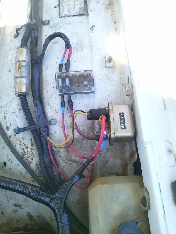

thank you, i dont think i have that link! I am sure the wires have been tampered with before and i am trying to fix all that. i took a pic today of it which ill upload in a sec. the cable on the right of the fusebox is for the MSD the otherone (thick red cable)is to the voltmeter inside. What i IMG-20130908-WA0000.jpg

You don't have fuseable link but someone did a good job protecting is there power on both sides of both of those.fuses

Yes Gauges are all stock. I already did a lot of wires, I installed that fusebox yesterday after... well the sparks were flying before (eyeroll) and i had to shake my head how there wasnt even a fuse inbetween that big wire... had been usng the car a couple of times since then actually with no problems. I didnt check on the voltage on the Fuse actually. Hmm, and so the Voltmeter is always straight in the middle? Cause i remember it was always slightly lower and then when turning the key i would make a move..

I got the car home! Thank you so very much, i simply did not know that everything runs over this wire. It simply was the Fuse. 15AMP is not enough for that wire, i had already guessed that 30 would be better, but thought it would only Wire the ampmeter! just bridged it and everything worked instantly. Thank you!
Glad you got it home not sure what size fuse you need there that is where fusable link is, i would say thirty not enough amp gauge probably reads 40 allthe way on c if car has power windows and a/c its probably a 65 amp alternator and every thing for whole car goes through that wire basically, you need to research that you don't want to big and burn up harness or worse yet whole car . Good luck and welcome to the site.
The prior owner worked on your wiring quite, and appears to have known what they were doing. Did they leave drawings? Not sure why you say "voltmeter". 1968 cars had an "ammeter" in the dash. I suspect the p.o. changed to a voltmeter indicator for current, driven by an under-hood shunt resistor (shown in photo). Many would consider that better, since the high current to/from the battery doesn't have to route thru the bulkhead connector and ammeter (causes many problems).
I simply wasnt sure if it was a volt or ammetet.sorry about that. How do i find that out? It seems pretty unstable and moves fast with the cylinders firing. Idk what the p.o did but the wires were not great, partly just 'twisted' togeter..... i just installed the fusebox there you see in the pic as i renewed a bunch of wiring. No drawing. Under dash wires already caught fire cause of some stupid mistake.... but it does not look stock. Like i said, electrical connections where i could just shake my head over.
