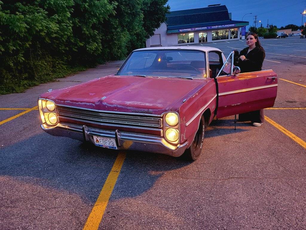

Ok guys ! Very weird situation here...car was in a photoshoot yesterday , ran super good , and after a couple of minutes of driving and stopping the engine for different angles, the car just refused to start when it was shot off , started with a click sound ( starter ) and slowly lost all power...no more lights , volt gauges goes up 1 time out of 2 , no cranking , no power with test light , no burn smell...it never happened to me before , even took a brand new battery from my truck and it didnt do anything ...so , no power / no lights / no cranking but a strong battery , relay ? Electrical gremlin , ..what could it be ! stock 1968 fury III 318 / 727
