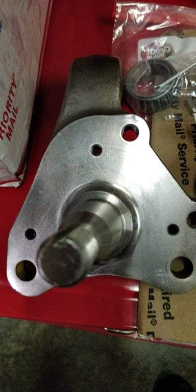

    with the couple of pictures i have included you can see the tooling marks , when they block welded and re-bored the hole...

    The welded and machined hole doesn't bother me much as long as it was done right, although it would be better to have drilled it correctly in the first place.
    The spindle height does scare me though. That's screwing with suspension geometry.

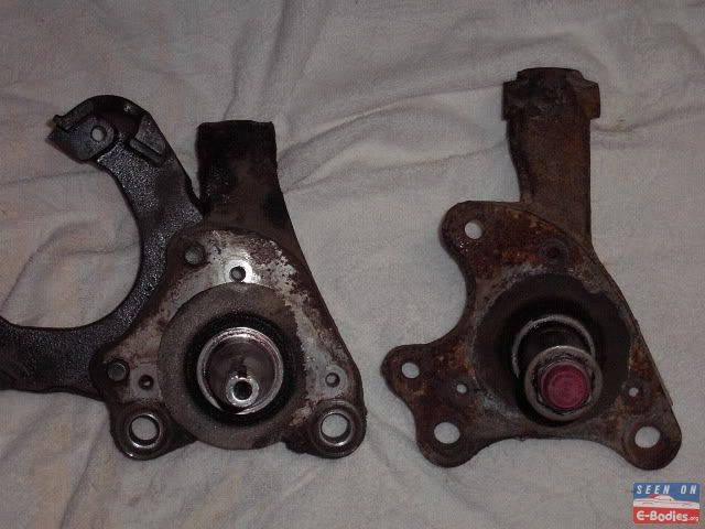

    there are lotsa of pictures , but here is one , i found when i had to present my case ,
    I have lots on my phone but can't access them

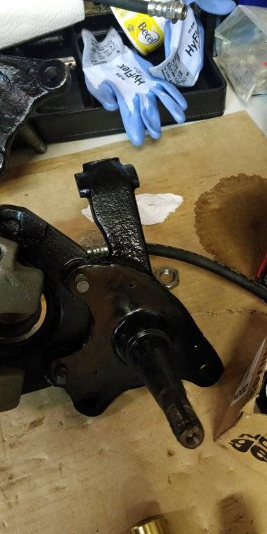

    Heres a few more , with so called new spindle and a proper c body spindles

    Marcellus, NY
    These two images may really be telling the tale.

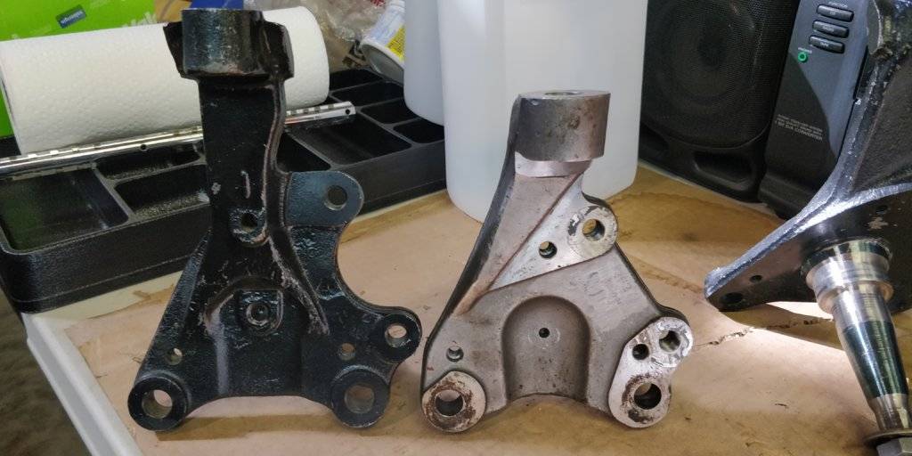

    IMG_20200409_155754.jpg Here you go , the ram man spindles versus the proper c-body spindles, look at the height difference , and look at the caliper bracket bolt spacing , unbelievable that this moron is allowed to continue doing this
    • Agree Agree x 2
    • Thanks! Thanks! x 1

    That's incredible and I can't believe that was passed off as fitting a C body.
