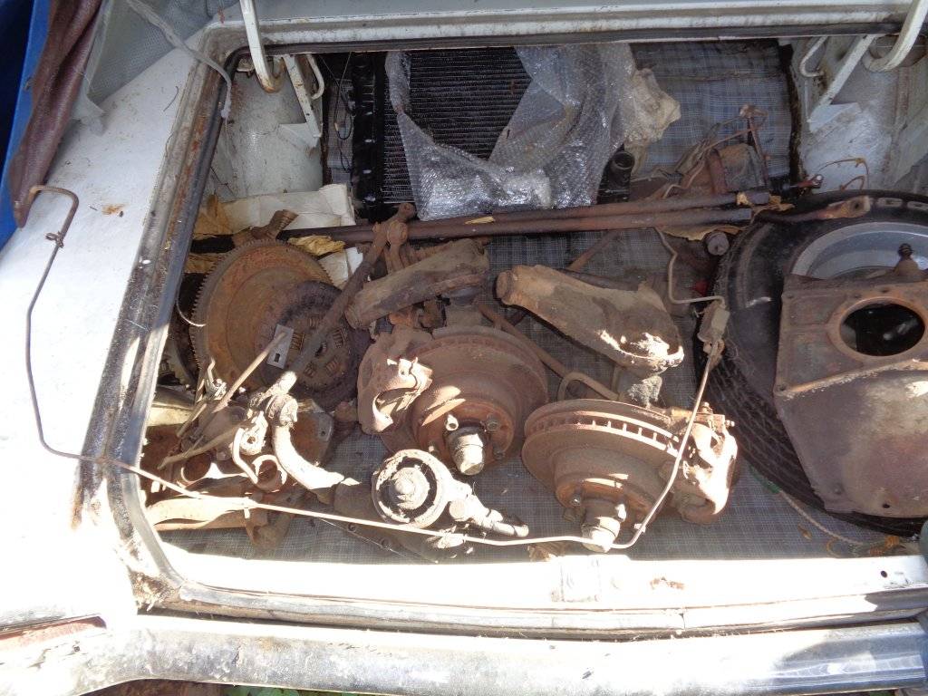

    He's a joke
    All he did was take a e-body repop, and spread the lower ball joint holes, you should have seen the video he put online be-rating me for calling him out , he has and he has since removed it , let's not even talk about the the phone call, OMG if I could have recorded it , he called me every bad name on the planet

    When you had told me about the height difference I knew it was bad but when you see the spindles side by side it tells the story. A little bit of knowledge is a dangerous thing ! Under no circumstances are you to weld on any steering parts on any automobile !!! The metals tensile strength changes completely and can cause catastrophic failure!!! This will void any and all insurance and leave you completely libel in the event of an indecent or accident. This was taught in welding trade school 35 years ago and still holds true today. Don’t walk away from those welded spindles,RUN away from them!!!
