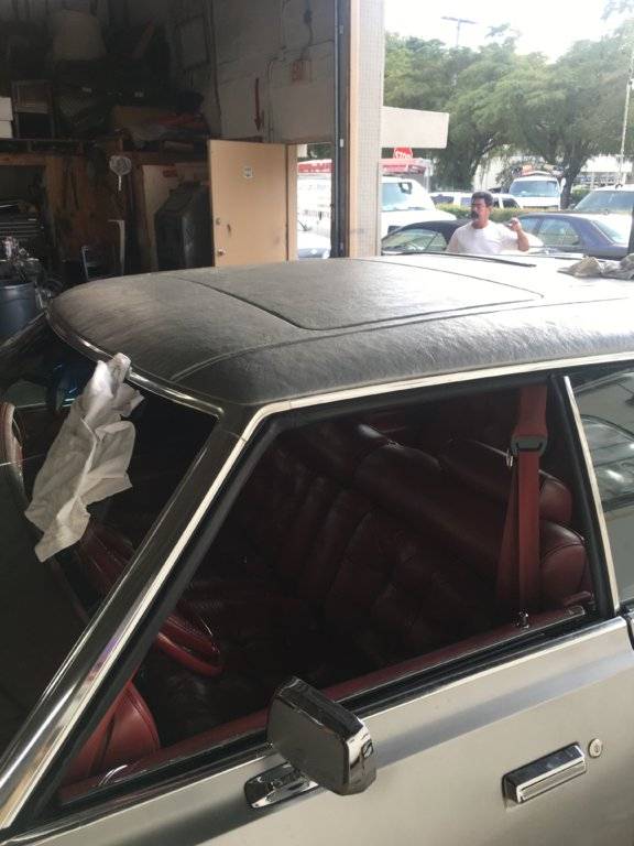

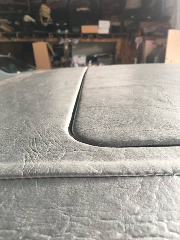

That new vinyl top looks very impressive. I need new vinyl on my car but super scared of trying any shops in my area.

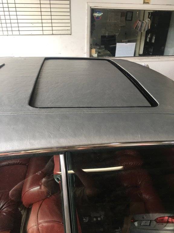

panel in but I forgot to set the pull down springs.... so....much cussing followed by removal of rear drive connection and setting the springs. Then came the adjustment

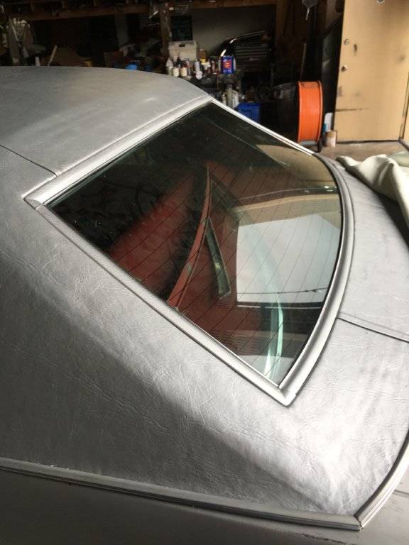

Rear window trim is an almost perfect match to the new top material.

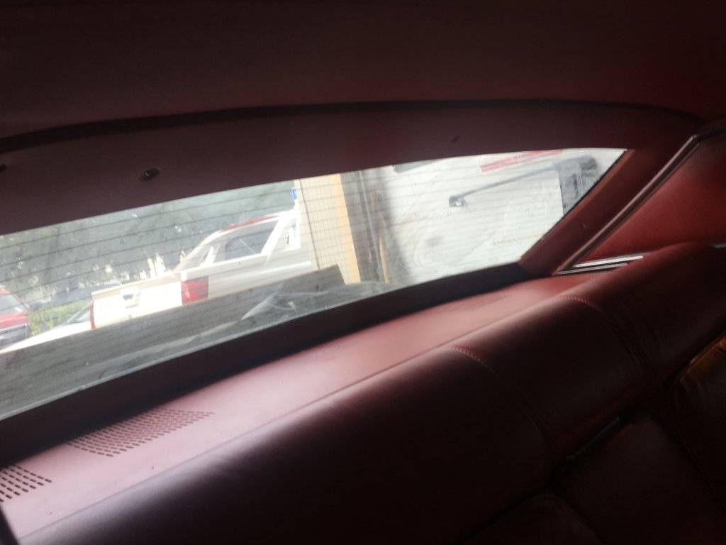

Rear trim panel (one piece) fit like a glove and color match was perfect.

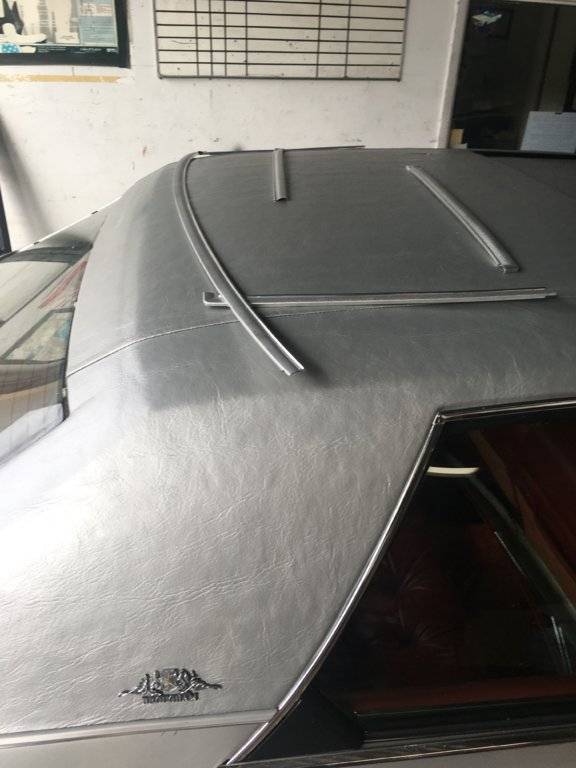

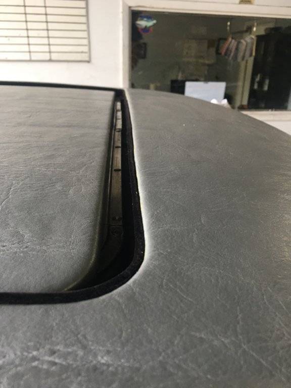

Panel is first aligned front to back on the rear drive connectors and then side to side on the front glides.... but leaving at least an 1/8” total play.
Then push the crap out of it to the front with the motor and your arms to compress the front seal and help the motor rotate the rear drive connector pivots up to set the rear seal. Check alignment and if ok leave it overnight to allow everything to take a set.
Front alignment... check.
Overall fit.... check.
