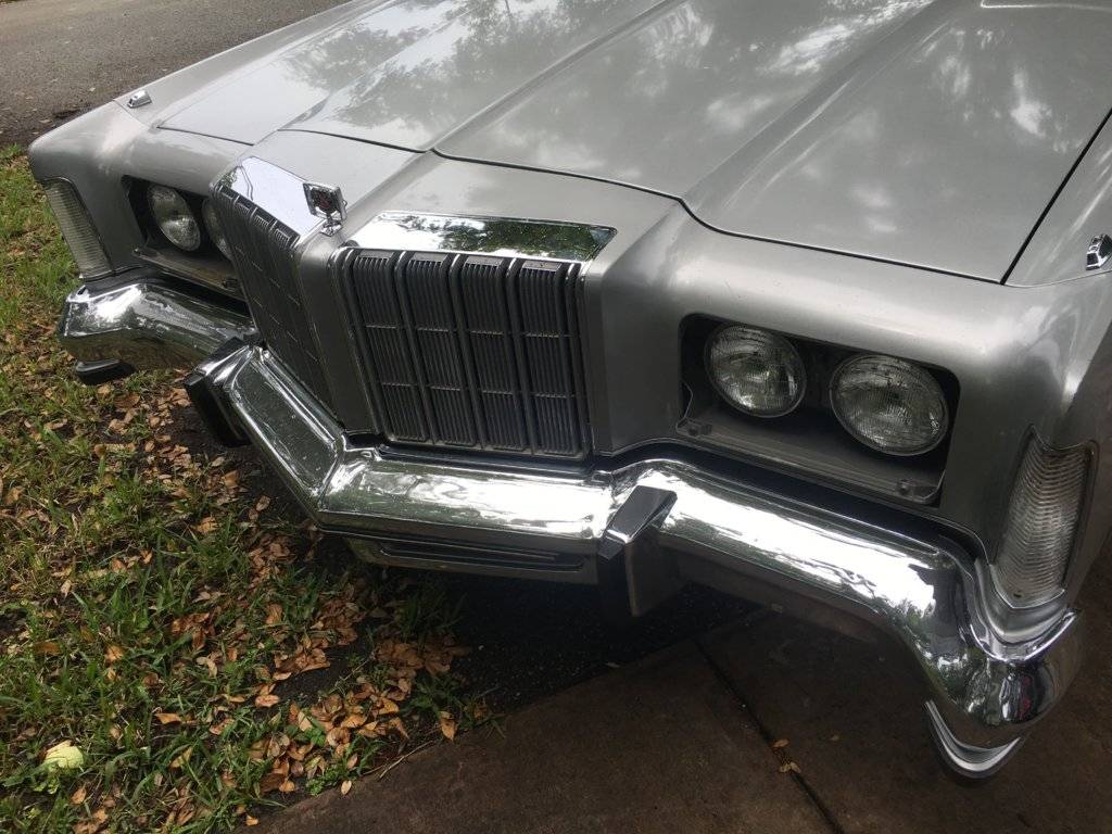

Bumper out and as good as before.... which is to say.... so so.

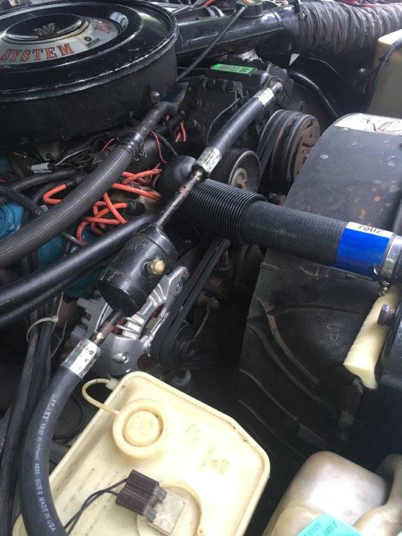

Checked fan clutch temp at thermo valve with IR thermometer after run....195 with radiator temp at 210. ( guage reading top of normal operating temp..... note to self with regard to reading). New Hayden 2747 fan clutch ordered... thanks Jeff!
Put guard on top hose just because.... because.
Working on vacuum lines now.

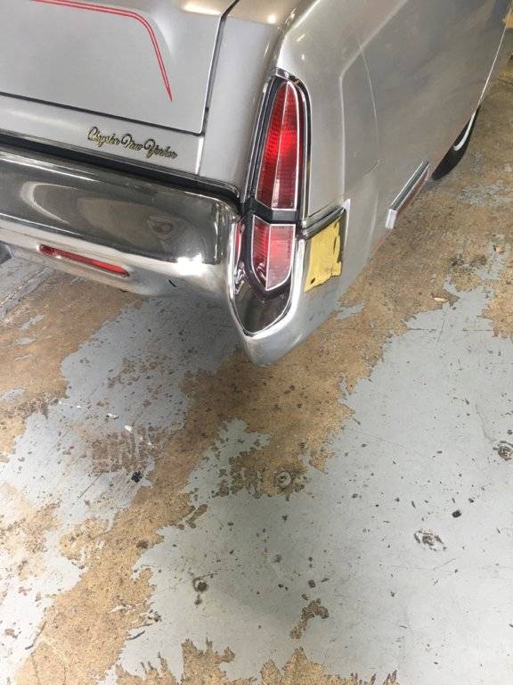

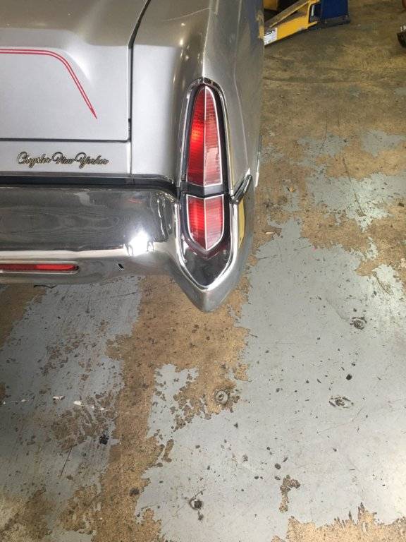

A little crowbar and wood blocking. She popped right out on the right and back in on the left.
Head on view... light lines up again
3/4 view... no harm; no foul

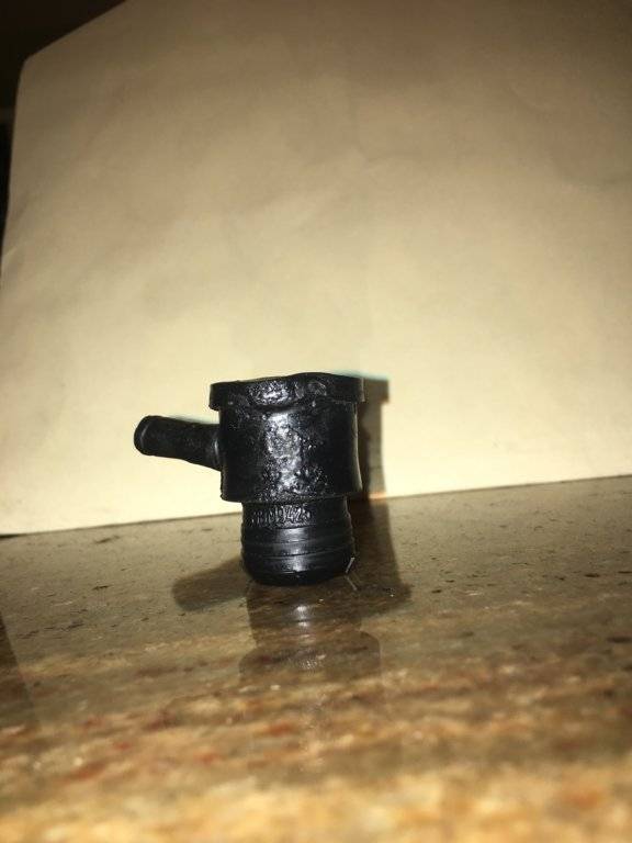

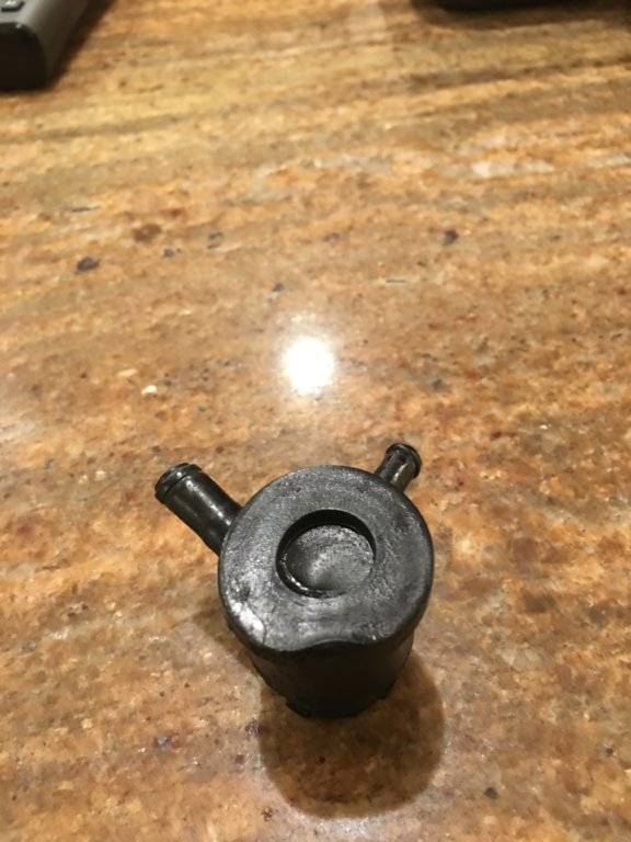

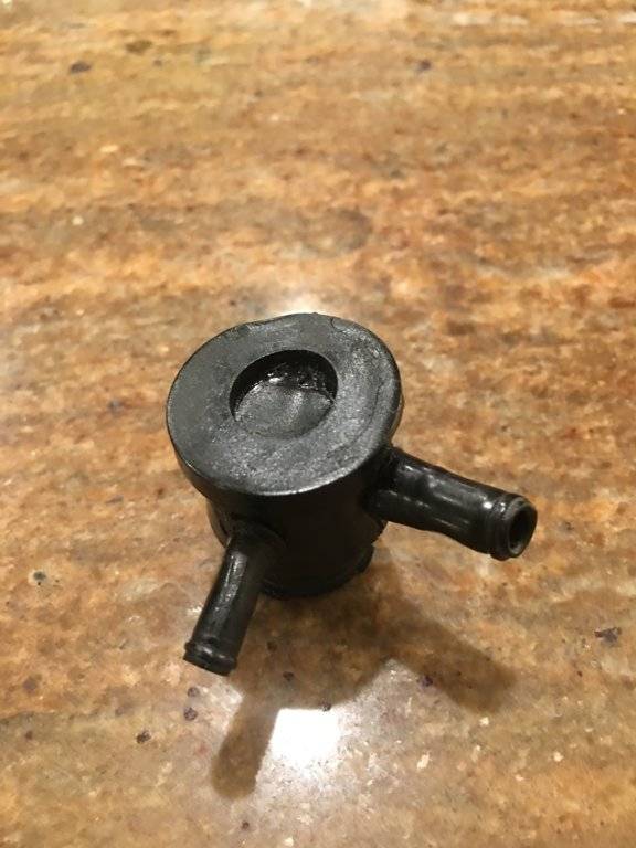

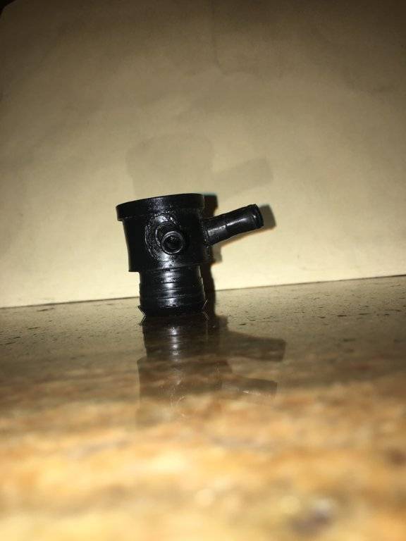

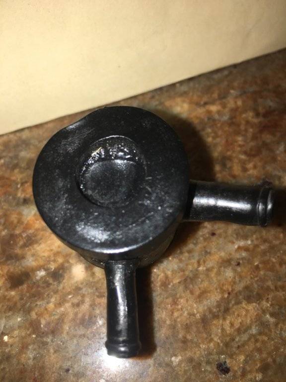

not sure this was leaking but, as a check valve, it’s done
New one ordered.
