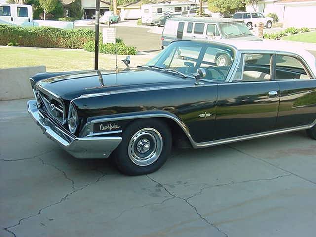

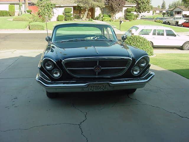

The grill might be from a '62 New Yorker; they used the 300 style grill in that year.
The heads on the big blocks changed in mid-year on '62. Early heads only have 4 nuts for the valve covers, latter had 6 as they did for the remainder of their production. If your has 4, you have an early '62, or even an older 413.
The "300 style" grill on a '62 New Yorker.

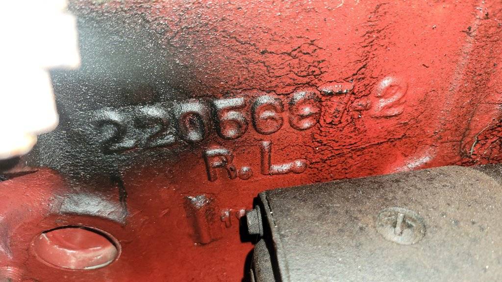

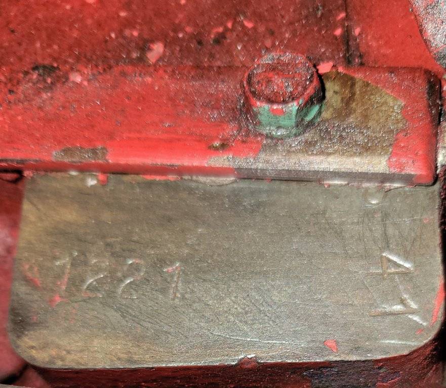

Well, here is what I could find:
My research suggests the block code (2205697) means its a 413 from 1959 - 1964. I am not sure what the "-2" means. The stamp pad numbers may be a date code, but not sure. S-41, again from research, suggests this means S = 1962 and 41= 413 engine and some sources suggest the "41" also means "New Yorker". So, for example if it read S-36 it would have been a 1961 413 from a Newport, where "36" means both 413 engine and the model it came from.
Someone might have put heads on it then for any number of reasons
Those stamp codes look more like some inspection codes rather than anything related to the model of car the block came in, to me. Just my suspicion.
The "-" number after the casting number probably relates to the version of the casting cores used to cast the block. Such "-" numbers exist on later model year blocks of all sizes, from what I've seen. You might look for somewhat recent threads in here on where the date code stamps are.

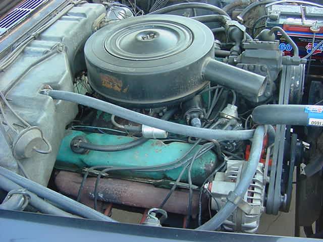

Orange paint? In '62 they were blue or black. Here is a 413 xRam from a 1960 F:
