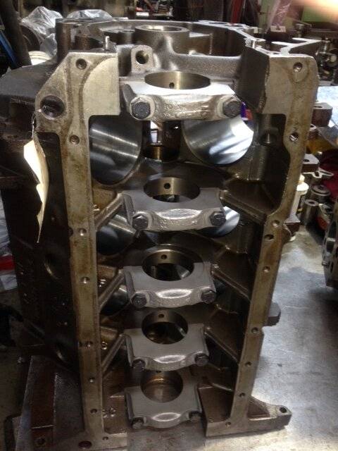

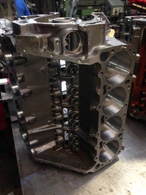

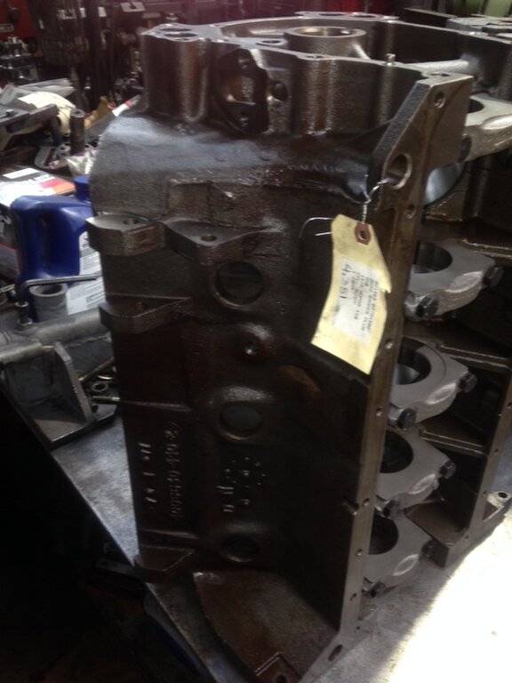

Ok boys and girls and fellow car **** lovers:
Here’s some pictures of the freshly machine and align bored block.
