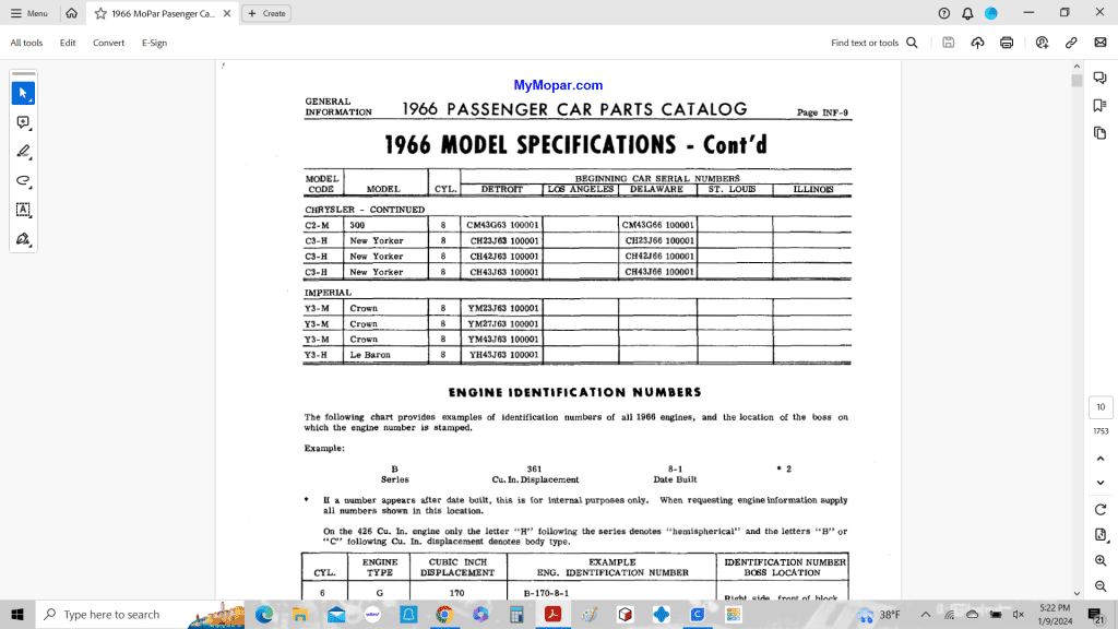

Just made a strange discovery, I thought I had a 1966 Chrysler New Yorker but after decoding the vin and trim tag it seems that maybe at some point my New Yorker may have started out life as a Newport according to what I have found the NY was CH42 but has CH23 also looks like the car was special ordered kind of puzzled if the factory made the Newport into a New Yorker or did someone at sometime changed the Newport into a NYr also has u1 code sold car (special order) everything on the fender tag matches what the car has for options any thoughts

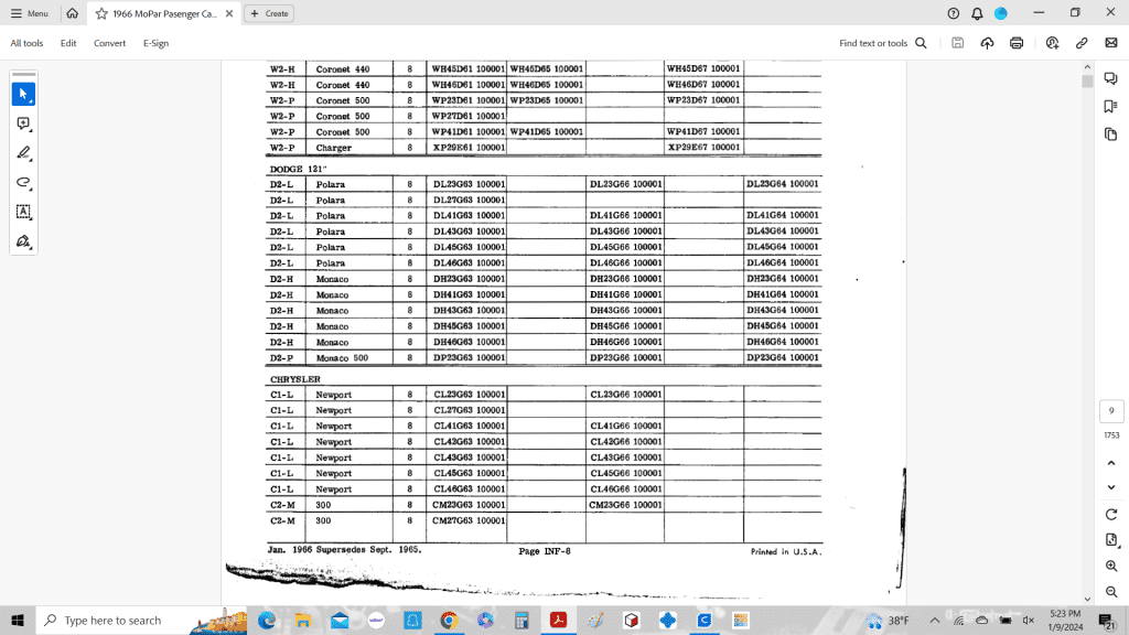

CH is a New Yorker. CM is a 300 and CL is a Newport.
From the parts manual available at MyMopar Pages INF-8 & 9

CH23 would be a 2-dr hardtop, with CH42 being a 4-door 6-Window sedan. Both NYers. In '66, Newports would be "CL". The Newport 6-Window Town Sedan was the pre-cursor of the '67 Newport Custom, as it had its own unique seat trim, it seems to me.

Newports in 1966 were "Chrysler Low". With the introduction of the Newport Custom model in 1967, the Newports became "Chrysler Economy" and the Newport Custom became "Chrysler Low". 300s maintained as "Chrysler Medium" and NYers maintaining "Chrysler High". As defined in the Chrysler FSM and parts books.
