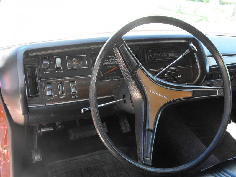

You guys probably did it already I'm slow. I was wondering if I could put one of the newer radios with cd or cassette into my car. I realize the harness is different, but I've seen some adaptor types. I would really hate to cut up the wiring if it wasn't necessary.

At the very least you have to abandon all the existing speaker wiring because you have to run new two conductor wiring for the new speakers. The OEM speakers which I guaranty you are fried are single lead common ground.
You also will have to splice into your headlight switch for the day/night mode on the display to work. You then can use a Scosche adaptor to hook up your instrument panel lighting, and power lead. You will also have to splice into a the battery circuit for the radio memory.
It's NOT Plug 'n Play.
