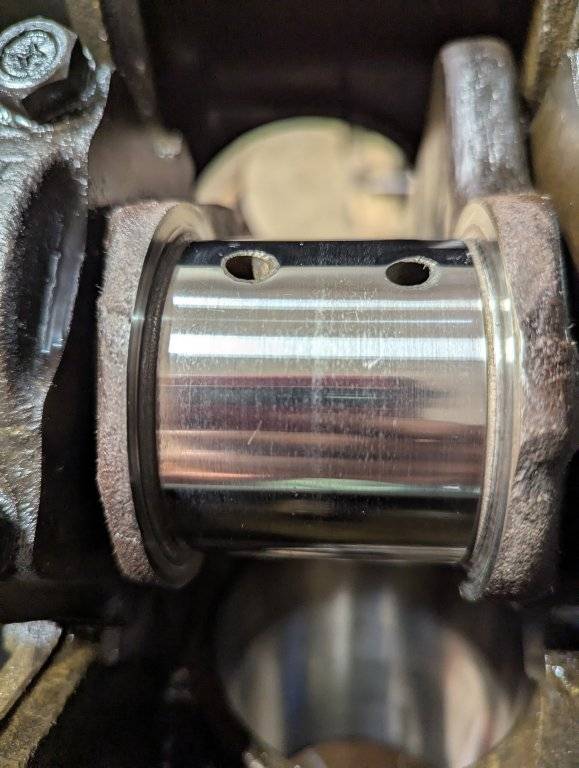

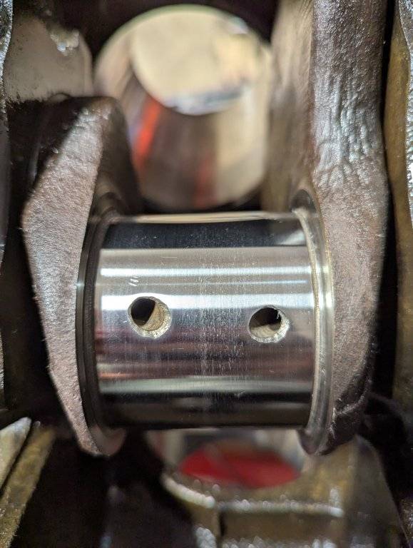

Nick in crank journal, machine shop or??
really shouldn't be doing that in the engine...should be doing that with the crank on an engine stand, followed by a thorough cleaning of all the passages...all the grit is going into the oil holes which connect the rod bearings to the main bearings...recipe for disaster
Thank you for voicing your concerns, I do realize it's foolish, what else can I do differently?
The engine will still be further disassembled for an entire rebuild is in motion.

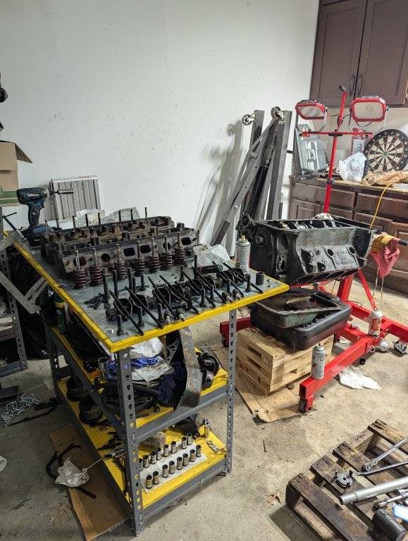

There's an engine stand & I've got the engine sitting on right now, I need another one? Just for the crank? Or just moving the crank to a separate bench if able?
Not exactly the most sterile place, but this is what I have concerning bench space or what's used for.

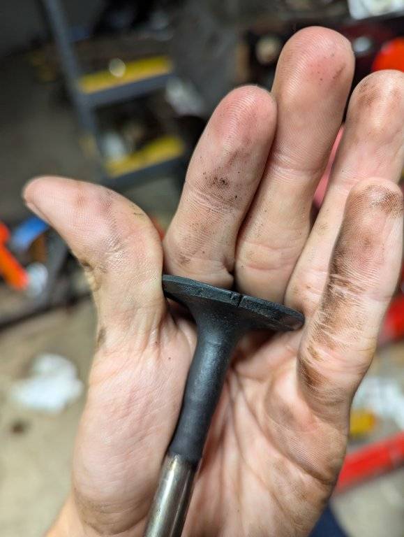

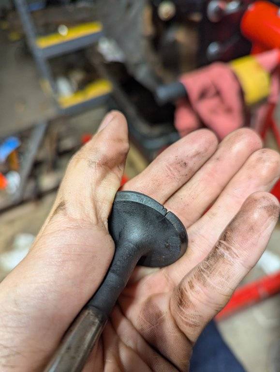

Also, was inspecting the valves earlier.

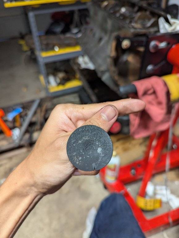

In particular, this exhaust valve is literally "exhausted" with being in this engine, time for a new exhaust valve, maybe 1.74 valves?
I hear that the 516 heads are a bit more finicky to install bigger valves without breaking into a water jacket? Or was it the other way around where the porting will have to be more conservative?

As long as you remove any part of the nick that's protruding above the surface of the journal and make sure it's back to flush, you'll be fine; a slight indent is okay. I also did this, but to the crankshaft. The machine shop that did the block work took care of these for me, but that's all they did was to take down the high points. I'm sure you could do this on your own if you take your time and use the right tools.
Gotcha, thanks.
Still working at it, I've got the journal now pretty smooth, going to make some measurements if any high points are left.
(First picture: to the left of the journal 3 distinct nicked lines)
(Second picture: using as a quality check, the wear marks going around the circumference of the journal)

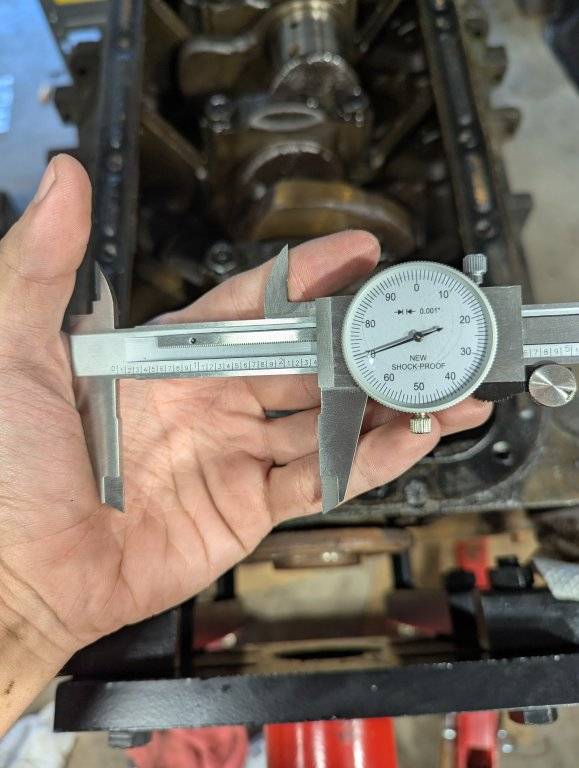

Got around to getting some Micrometers and mechanical dial calipers, here's what I was able to measure the crank connecting rod journals.
The readings are:
Connecting rod journals #1 #2
2.370
Connecting rod journals #3 #4
2.370
Connecting rod journals #5 #6
2.370
Connecting rod journals #7 #8
2.370
The crank big end journals doesn't seem to be oblong so I guess that's good?
You are going to have to use something better than the cheap calipers to measure the crank accurately. They are great for a quick measurement, but not for this.
Good calipers are only good to +/- .001". Out of the box "no name" Chinese calipers are all over the place, although I've been able to tweak most of them to the +/- .001" accuracy.
You really need to use a good pair of micrometers to measure the journal diameter. Those measurements you've posted are questionable to me (aside from the calipers) as you've mentioned the block being stamped .010 undersize crank journals. 2.3740-2.3750" being the nominal standard size. (Note I called out the 4th decimal place). To my knowledge, I haven't seen a .004 or .005" undersize bearing, so if the measurements are accurate, you're looking at grinding the crank. Noting the burnt valve and the condition of the journals, it doesn't surprise me if the journals are worn this far.
IMHO, I don't think you want to go to a bigger valves in your 361. Less is more.

Ok, thanks. Appreciate the words of wisdom, changing over to the Micrometers now.
Jotting down the readings and triple checking at the moment.
Oh ok, I'll inspect the other exhaust valves more closer for questionable damage.
Question; Doesn't using smaller exhaust valves improve low end torque, while bigger exhaust valves improve mid range to top end power??
Chances are all the exhaust valves have excessive wear on the stems and will need to be replaced. Nature of the beast.
Yes, that is true about valve size. Just remember you have a small displacement, small bore engine. Big valves won't help much, especially with the small bore helping to shroud the valve. A 361 is basically a torquey engine that they used in a lot of cars and trucks. Play to its strengths.
