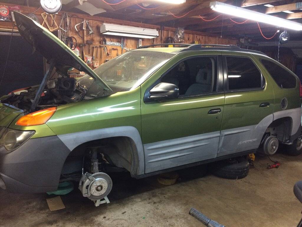

The car is a 2001 Pontiac Aztek with a 3.4 LA engine. After sitting for 3 years I am trying to get it back on the road to give to my son. I recently had to replace all the brake lines due to a leak and also replaced the front brake hardware, hubs and CV axles. When the car is off - the brake pedal is firm. When I start the car - the pedal goes to the floor. No ABS codes are present.
Here is what I have done so far to try and fix or diagnose this:
Manually bled the brakes - did this with a vacuum bleeder and the two person method.
I bought a scan tool that allows me to bleed the ABS module so I have done that about 3 times.
Adjusted the rear brakes.
Undid the master cylinder lines and capped them off. Pressed on the pedal and it is hard as a rock. I assume that would tell me that the master cylinder is good - ?
Now...I am suspecting that maybe the brake booster is bad however I would think that if it was then the pedal would be hard when the car is running - not soft. I also unplugged the vacuum line and the pedal got hard so I think the booster is OK. Has anyone ever experienced a bad booster where the pedal went to the floor when the car was started?
My other thought is that maybe the ABS module is bad but I would think I would get a code on that. Also if the ABS pressure valve unit itself was bad then wouldn't that give a code?
Any thoughts here? Appreciate the help....
