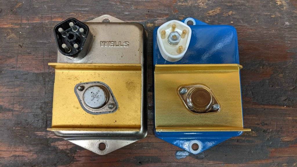

I had the exact same problem with my 1973 Monaco. Tilt column/Delco ignition, everything.
This ECM cured the problem.
for MOPAR HR7500 Electronic Ignition Module Dodge Plymouth Chrysler MAX RELIABLE | eBay
1970FuryConv
Aug 8, 2014
5,324
4,751
Richmond, VA
Note, when going to the 4-pin ECU, cut the dark green/red wire off the 5-pin connector. 4-pin ECU does not use auxiliary power. Also, you need a single ballast resistor. Second side of dual ballast resistor not needed with 4-pin.
Single ballast resistor
Blue is ignition run, brown is start.
5-pin (trash) vs. Rick's 4-pin
4-pin ECU and single ballast resistor cured the starting problem immediately.

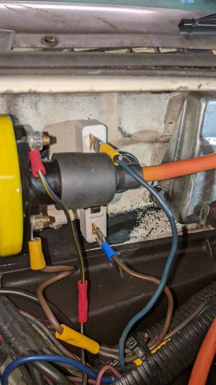

If I go with the 4 pin I don't need the duel ballast anymore?
Yes, you use a single ballast resistor like the one pictured.
The second side of the dual ballast resistor regulates aux charge to the ECU. 4-pin does not use aux charge.
For reference on Dual Ballast resistor: computer control auxiliary side: once the circuit passes through the jumper wire at the top of the ballast resistor the current at start goes down through the 5 ohms side, auxiliary side of the ballast resistor to the dark green/red wire that gives power for the ECU to send to the distributor.
Dark green/red wire is 5th pin, unused with 4-pin ECU.
