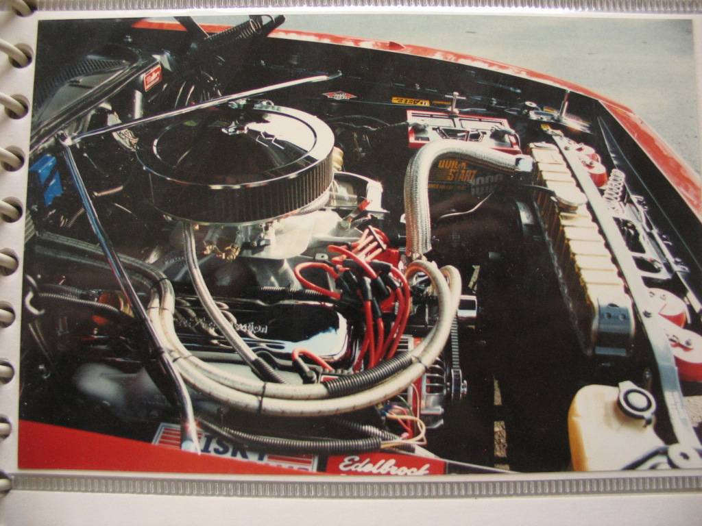

* The engine compartment got me the trophy, people barely looked at the body or interior, which was a little sad but probably good because I did the work myself with a backyard painter. ;]
Sent a bunch of stuff to the platers including fender bolts, pulleys, polished the radiator, it was stunning as well as balanced and blueprinted. Electric fans. Transgo Stage 3 on the street. Giant cam, Jan's 11.25:1 pistons, all used parts from local drag racers.
The .525/304 Isky bumpstick came out of local legend "Sugarbear" '69 Roadrunner race car turning impressive times with 300lb guy on board.
People were begging me to take it to the strip, telling me "I needed to take it to the strip" and I refused, too pretty, a 383HP I spent two years building, no thanks.
