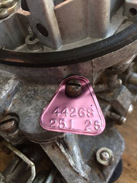

CBODY67
The carb should have a tag on it and can be referenced by the parts list.
