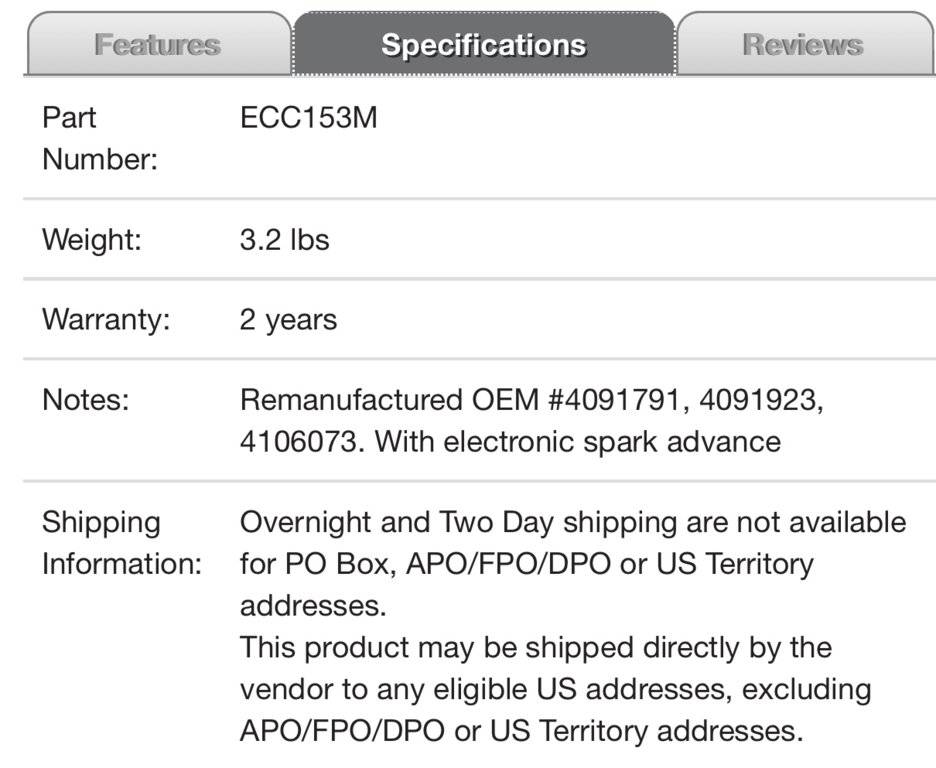

I’m pretty good at internet research but haven’t been able to find a complete list of the compatible computers and original part numbers for my 78. I was able to make one by looking at the aftermarket ones that are still available. Therefore, for posterity, here it is.
original part numbers I’ve been able to find for a 78 440 four BBL Chrysler are:
4091791, 4091923, 4106073
I got the above from the compatibility description for the Blue Streak Manufacturing (which also goes by the name of Electromotive)
www.arizonaparts.com/MoparParts.aspx shows a few more compatible numbers. 4094022,4091072, 4106079. There were a bunch of revisions to the original part numbers.

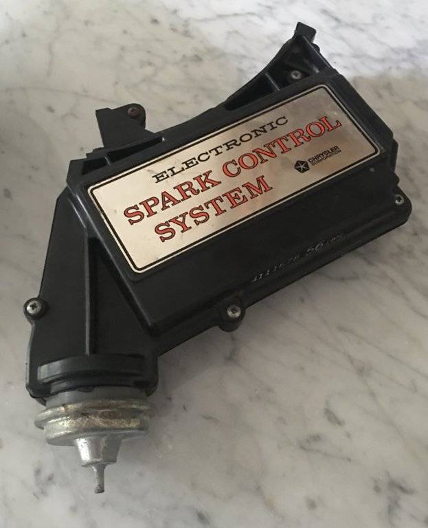

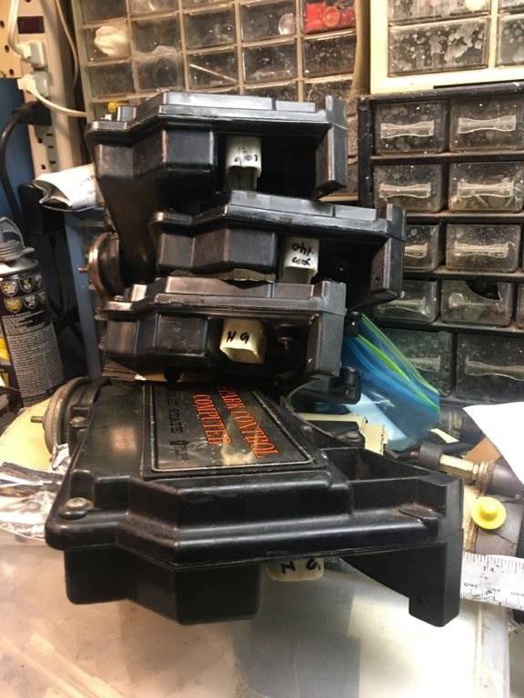

Here the collection I have that I needed to sort. One came in the trunk of the car when I bought it and one came with an air cleaner I wanted the lid from.
One of the good ones, besides the one in the car now, is not on the list. It is PN 4111441 and appears to be original. No foam underneath with reflective insulation like some of the rebuilt ones I’ve found. It also has all the pins in the socket.
The other one that works is PN 4111678. It has it’s foam insulation and all it’s pins as well.
The other two don’t work and are both missing the same pin which makes me think they are for another engine application entirely.

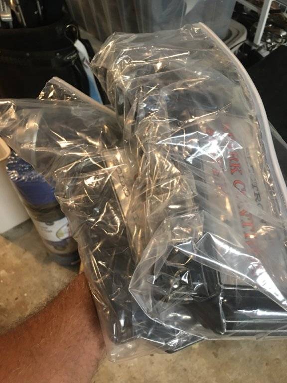

Well it finally happened....
The spark control computer finally crapped out.
First it sputtered, then it cut in and out, then it died completely, then it started and died and started and died and started and..... BANG!!! Smoke out of the hood and scared myself to death. Thought I was on fire.
Right in the middle of a coast down to a light on US1 southbound in heavy afternoon traffic. It was running like a charm until then having just come off the end of I-95 (it ends) after about 20 mile return trip.
I must have looked like a B17 making a crash landing on fire. People just got out of the way!!!
Totally unrelated to today’s bit of drama.....
I had done a slight adjustment this morning on the choke to see if I could get a smoother transition from cold start to full temp. As soon as it hit 150 degrees, the enrichment would cut out she would run sort of rough. I thought a bit more choke would work and it did.
Luckily, I had my working spare computer in the trunk in a zip lock bag and just piggy backed it right in to get the rest of the way home.
Got a year and a half out of it to make it 43 years old. Not too bad... the spare is a Cardone aftermarket rebuilt unit that works fine. I added the sticker to make it look correct.
Time to get another spare
