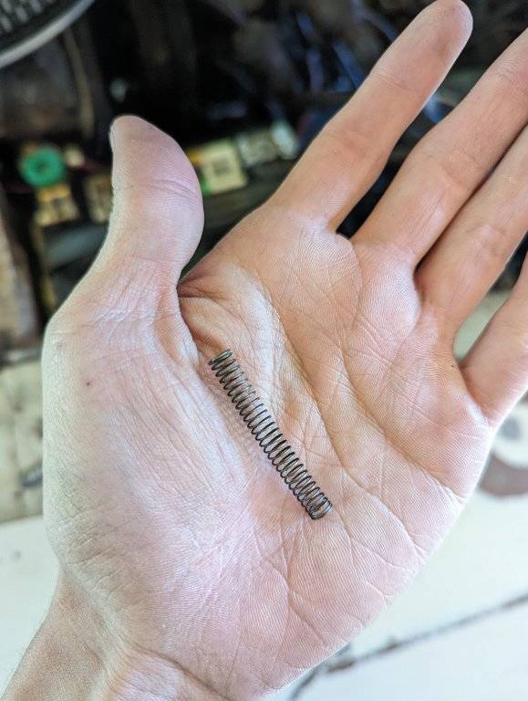

The Carter AVS mounting ear # 4635S, and pulled out a step up rod spring, which looks like the
7HG or 8HG of vacuum silver spring. Unless the color has been eroded away by the fuel.
Also, never thought to check the local chain parts stores for the step up rod Springs.
I'll search around a bit.

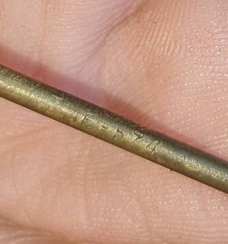

Try a blue or yellow to hold the rods down as long as it doesn't surge or hesitate. Dang that looks like a long spring, none of mine have any color left. Looking at the rods I have Carters have a P# like 16-241 that needs to be deciphered, Eddy has the size stamped like 76x55. What do you have? They are the same length. Only have 1 three step 16-572 not referenced in the kit. The 16-241 must be a close limit rod @ .0705x.0475 Holley makes close limit jets. Gnats *** stuff.

Anywho, the number on the rod looks to be:
16-574.
Reading the small numbering on the rod is giving my eyes a vision test, I've still got it. Lol.
Regarding the rod springs, I've found some Edelbrock springs a set of ten included is the blue/yellow/orange/pink/silver springs.
If the spring in the carb right now and the color is to be legit, I've got the silver spring, no bueno! All performance and no milage. XD

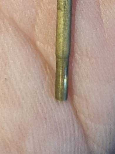

Also side note, judging from the witness wear marks on the rod, looks like it's mostly spending time at the bottom of the rod, so the narrow tip was in the jets.
(Notice the shiny part of the tip versus the dull top end of the rod where it doesn't look like it has been dunked in fuel)

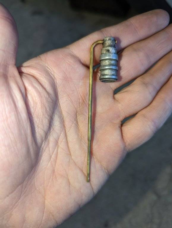

Zoomed up picture of the shiny spot on the tip of the rod below.
Sorry for the late reply. After 50 plus years **** wears out, like that rod and the power piston. If the piston and bore are worn the vacuum signal will be compromised and not hold the rod in the correct position. You can run it with the little cover/ rod holders out of the way for a visual of what they are doing. That piston looks pretty crusty. Is there a size spec for it? I am sure there is but I don't have one. Same as the bore in the carb. Think re-ringing for a better seal. Just spit balling here. Did a search for 16-574 rod no luck. Was trying to find something comparable.

So according to CarbKing @ The HAMB, lists the strip kit I need to tune the AVS, Kit # 10-106.
This kit tunes most AVS's,
AVS # 4401, 4424, 4425, 4426, 4428, 4429, 4611, 4612, 4615, 4616, 4617, 4618, 4635, 4636, 4637, 4638, 4639, 4640, 4682, 4711, 4732, 4734, 4736, 4737, 4738, 4739, 4740, 4741, 4933, 4934, 4935, 4936, 4937, 4960, 4967, 4968, 6125, 6433, 6434, 6435, 6436, 6437.
