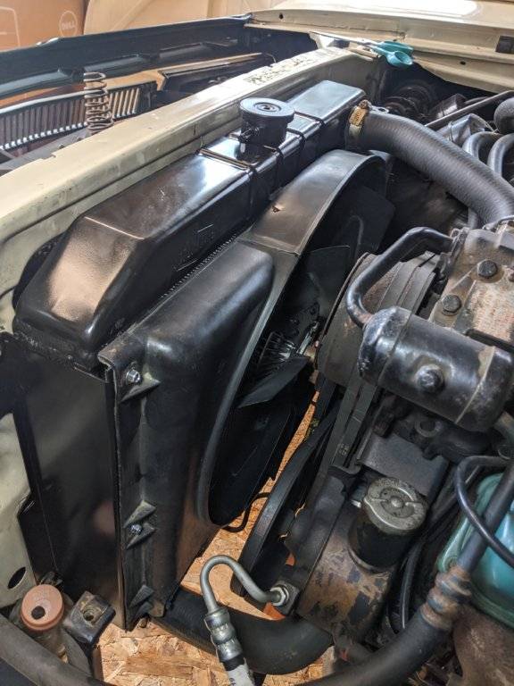

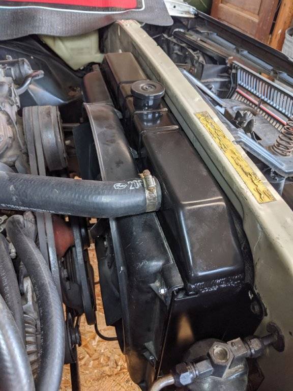

So... I developed a leak in my radiator. Shopped around to get it recored, ( to keep original), however, that turns out to be $$$$$. So, as I don't have a Hemi Cuda going to auction, I looked at aftermarket. Read the thread on Cold Case and decided to give them a try.
The good:
Priced reasonably
Nice support when I called.
Very nice product,
Made to fit my 69 300.
The bad:

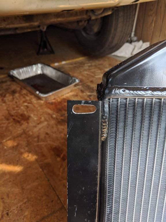

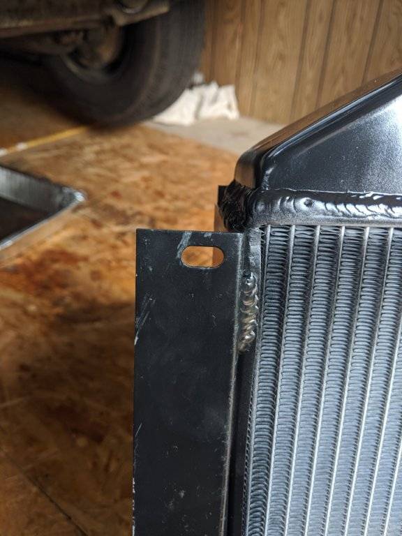

I had to elongate one slot, top passenger side

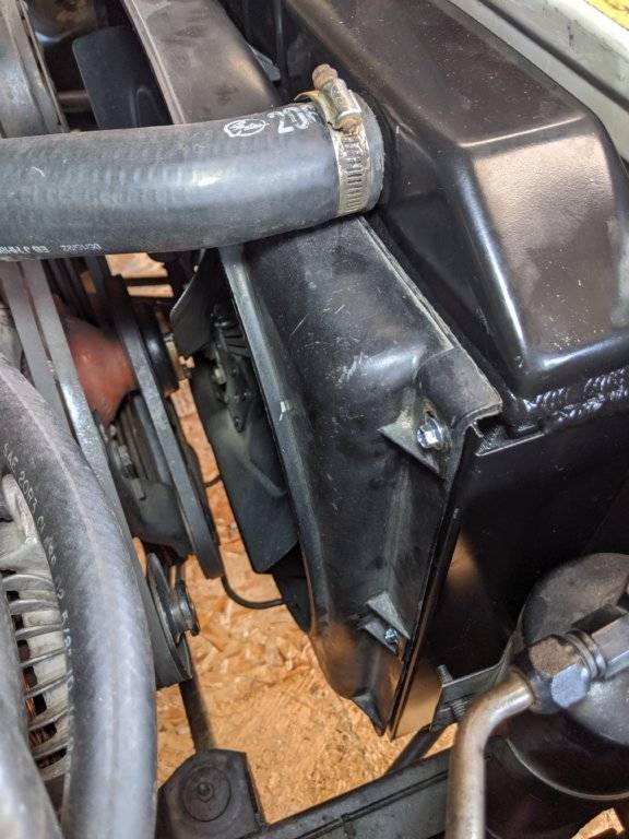

My tranny fittings were 1/8" thread cold Case takes 1/4"..
Shroud mounts us a 6 mm screw, and I could only get 4 out of 6 to line up.
Now, none of the above is a deal breaker, just info for future reference. I plan to call them tomorrow and give them my specs from my car. Maybe something they can adjust for.

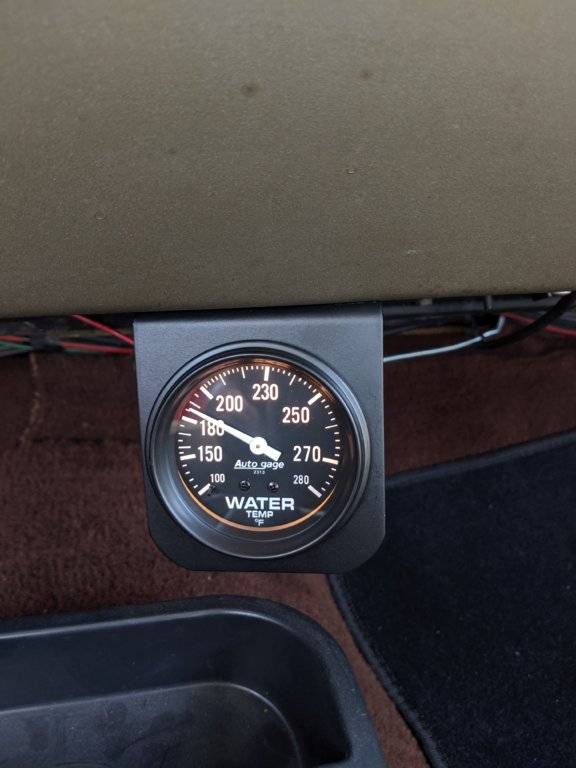

After install, I test drove, 88 degrees today, in traffic...temp never busted 190.
For the money, the above adjustments were no big deal. I would recommend Cold Case
Pics show slot and installed, and temp.
