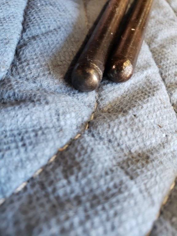

I began taking the heads off my 440 to swap on some mopar aluminum heads and tti headers and I found on cylinder number 3 the pushrod ends and rockers on just that one cylinder show signs of oil starvation. I see the ends are welded shut. My question is would pushrods with oil holes help prevent future issues with dry rockers? Or will it cause a low oil pressure concern With 16 more "oil leaks"?
The cam that's currently in the car is a comp xe 274. As far as valve train have not bought that yet. Currently putting the alumium heads on to measure piston to valve clearance.
NO. Mopars oil from the rocker arm shafts, there is a small hole in the rocker arm at the push rod hole to lube that.
Your rocker arm shaft looks rusted. Are the oiling holes filled with crud?
The ends are not welded shut, they were never open.
This is not a GM, no pushrods oiling.

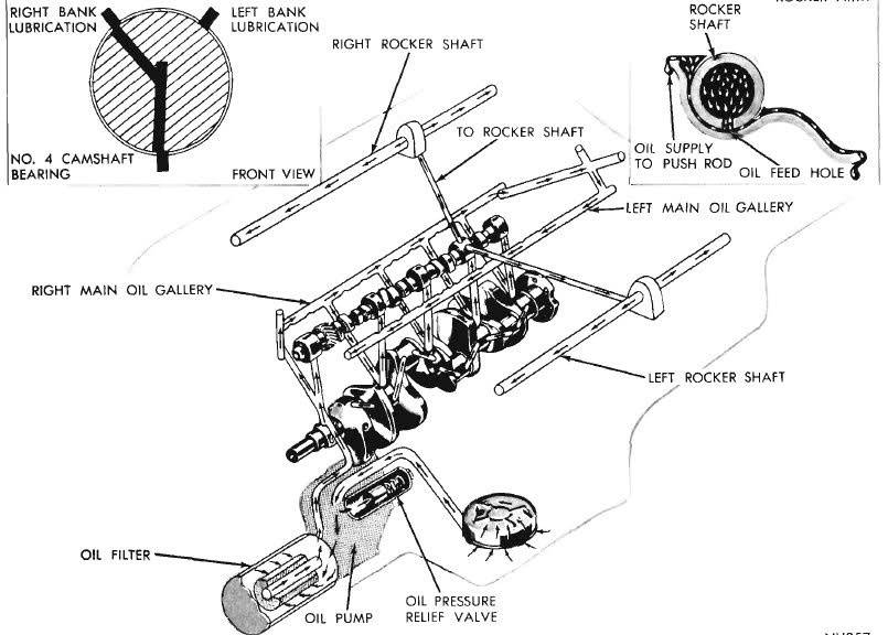

You got a oil passage restricted or clogged. No need for for changing the pushrods to oilers your problem is in heads or block. Check your service manual for proper 440 oiling, here's one for a 360 (all about the same)

Most likely, if only #3 is showing distress, the oil hole for that rocker in the rocker shaft is plugged. A misaligned cam bearing would starve the whole set of rockers for oil. Pull the rocker shaft, it is probably full of crud. You will probably need to replace the shaft as the dry rocker has probably cut a groove into the shaft. Be sure to also replace that rocker as well if you are not going to replace the whole set as it is going to be badly worn as well. If you are replacing the camshaft with a high lift unit, the rockers should be replaced with ones that are compatible with the lift of the cam.

Rocker holes look clean. Every other rocker in the engine is clean and has oil on it. Seems to be isolated to number 3. This motor was actually rebuilt a year ago. Has a set of kb pistons in it. Will likely go with a set of 440 source roller rockers since this camshaft isn't stock
