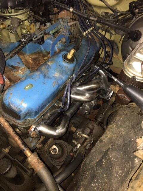

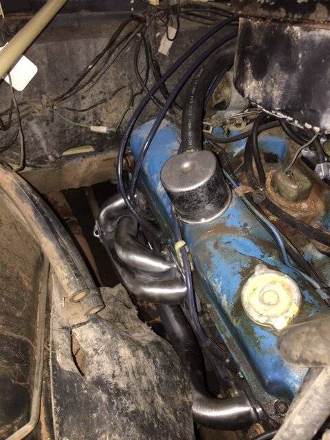

    Hey there feets, I saw your question so figured i'd chime in.
    My motor and car are a bit different than yours ( I have a 72 Fury Wagon, 360 automatic transmission ) but I did manage to fit a pair of Sanderson block hugger headers on mine.I just had to replace the original starter with one from a early 90's Dakota. I put some Flowmaster 40's and duals all the away back and all seems to work well.
