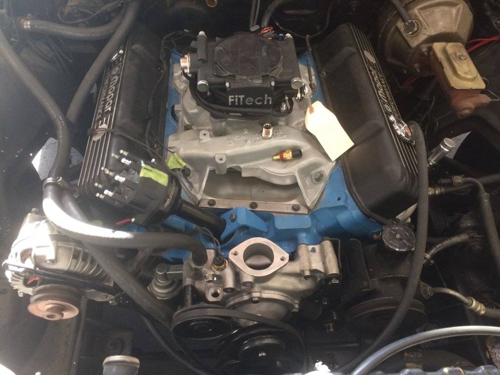

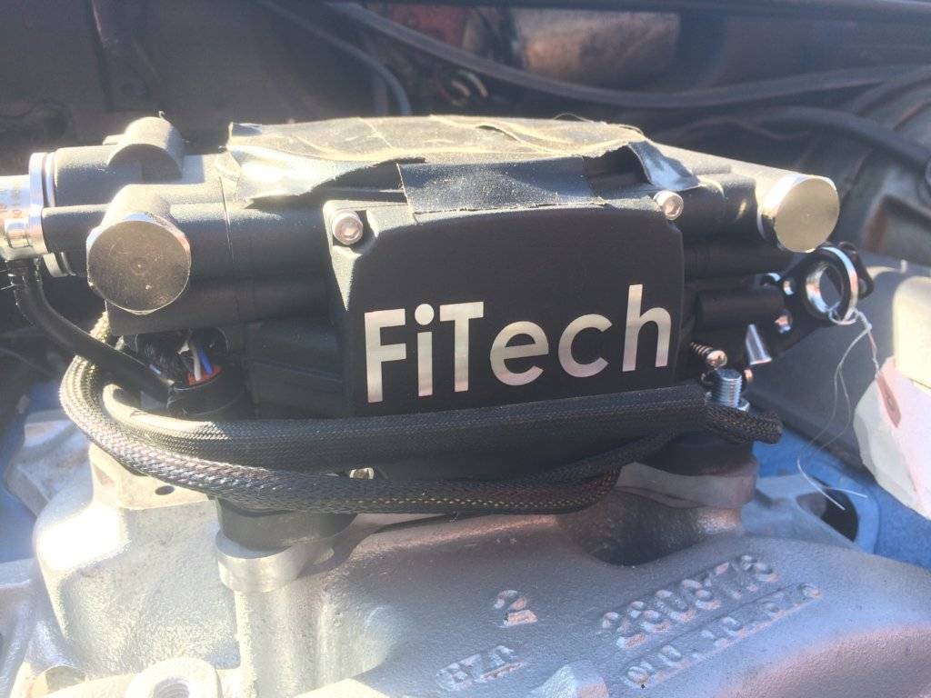

Stopped by the shop yesterday to find some more work done on the engine... The FiTech is now mounted on the engine. Take a look!

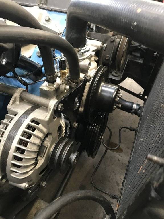

Need to reconfigure the alternator and realign some pulleys to account for deleting the AC (let the hate begin), but things are moving along. More pics soon, I promise.

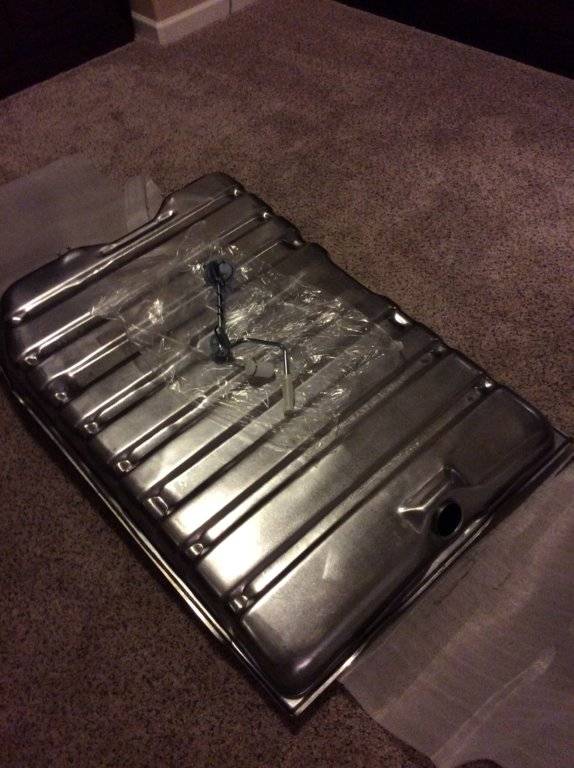

And following the advice from the mechanic, I ordered a new gas tank (and sending unit for good measure). It was delivered today! woo hoo (don't tell Mrs. SPF I set in on the new carpet to take this picture). :D
New tank is in! Alternator pulley is finally lining up and new power steering pump is going in the week. As the title of this thread states... One Step Closer!

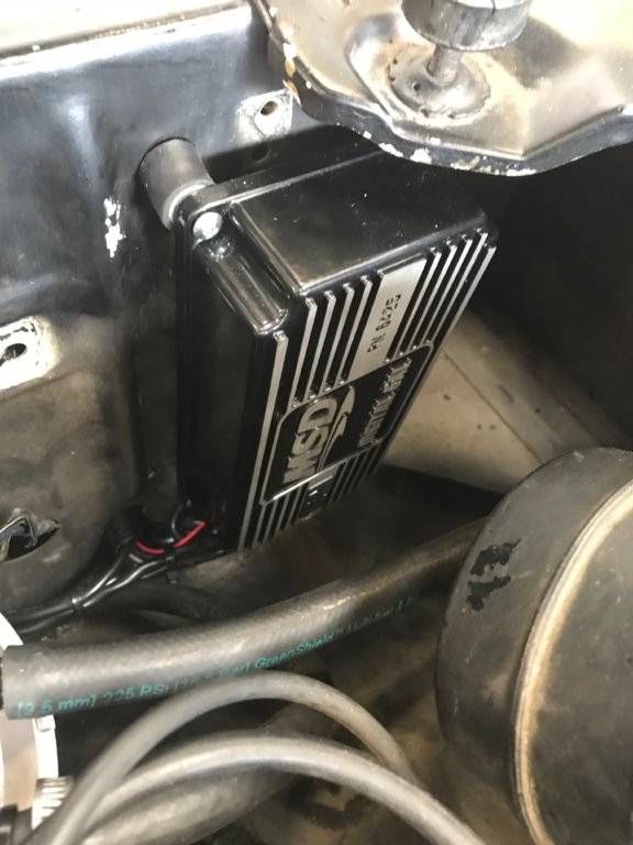

Horn relocated with new MSD box in its place:

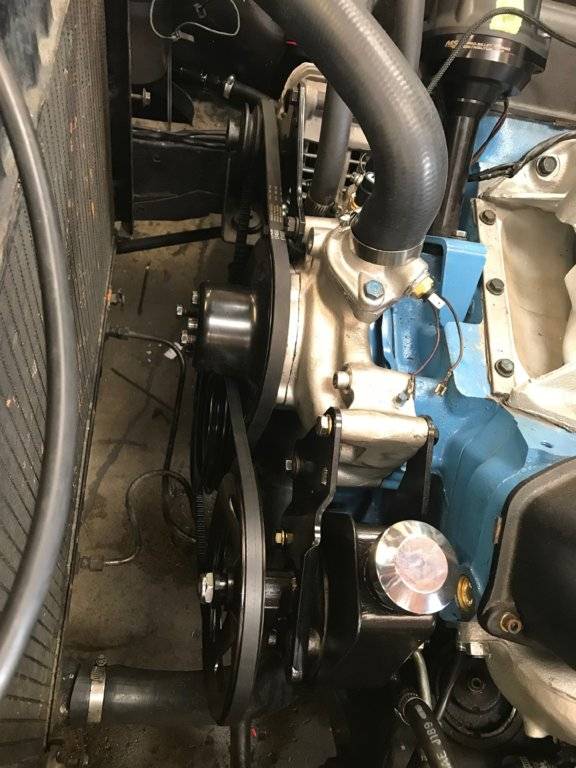

Belts lined up (finally) and new power steering pump installed.

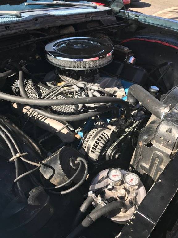

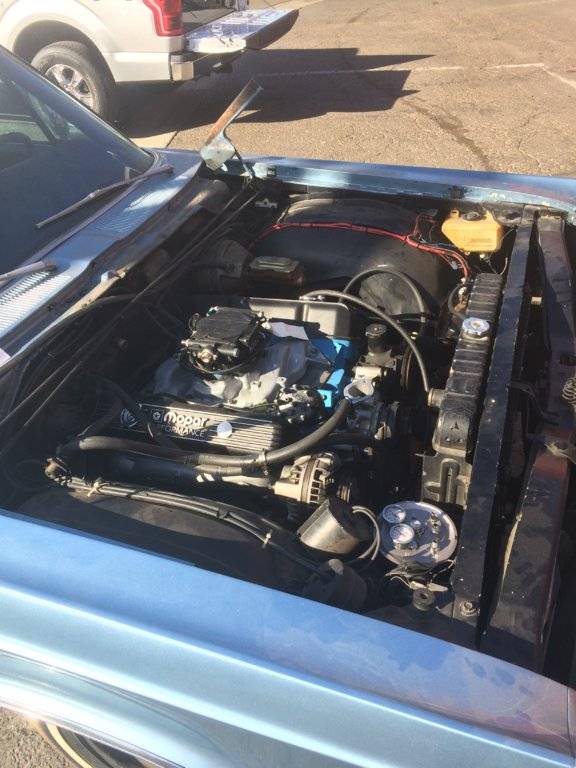

Back in December my mechanic said a couple of weeks til the first start of the new engine... well I think he meant a couple of months! I am happy to report the engine was fired up this week and it sounds like things are looking good. And just in time as the weather is starting to turn to Spring here in Northern California. Still a handful of small things to get done, but I suspect I will have my car back soon enough. Yahoo!

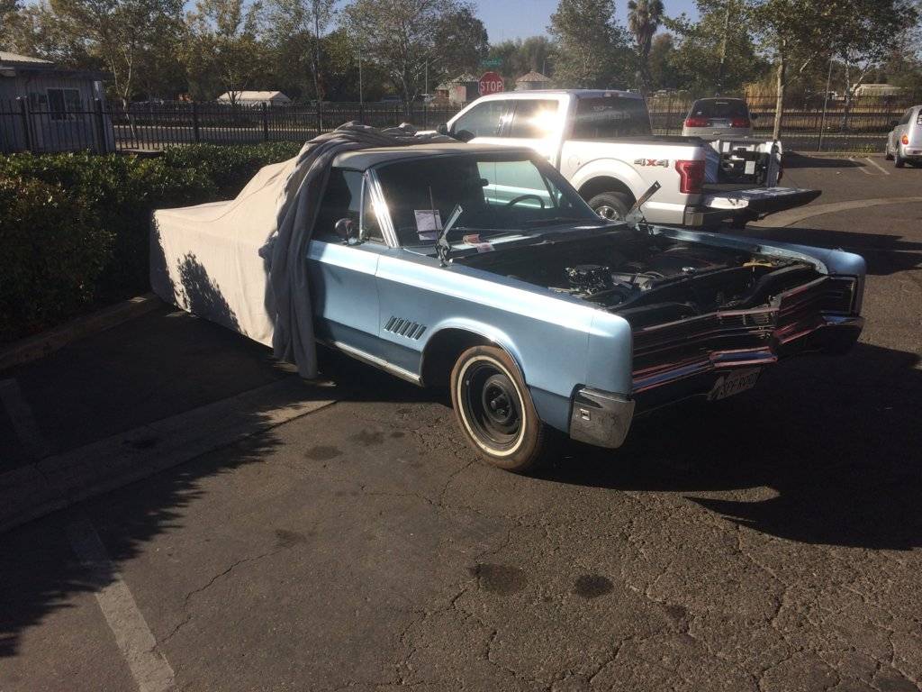

So I swung by the mechanic today because they are very close to wrapping up the project. I was so excited to see my ride out getting some sun with the hood finally on (still needs alignment) ! One of the items they had to finish up was some work on the passenger side exhaust manifold.... that’s when they delivered the bad news. It would appear when the engine rebuilder (not my mechanic) did the work, they did not replace the manifold studs. And the one at the front passenger side snapped off leaving half inside the block. Nooooooo!
So...it sounds like it will still be awhile before I get the keys back, bummer.
But knowing how much you guys like pictures, here are a couple to tide you over.
