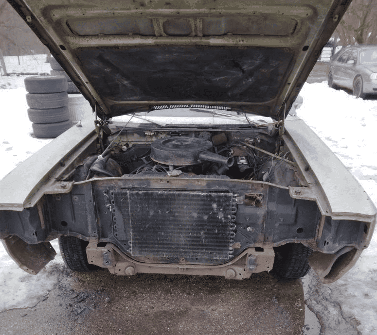

my 1969 300 Vert. project in final stages of dismantling early last month.
Other than age/dirt/patina, exactly as it rolled off the line (body color "F3"). everything was what looked like "flat black" in front of rad. support, just like when it rolled out Jefferson Ave Jan 1969.
Yes, fairly "sloppy" far right & left, underside front edges of fenders, and as pointed out the rad. support under/thru the black was body color.
