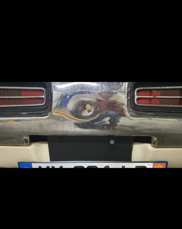

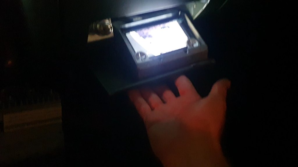

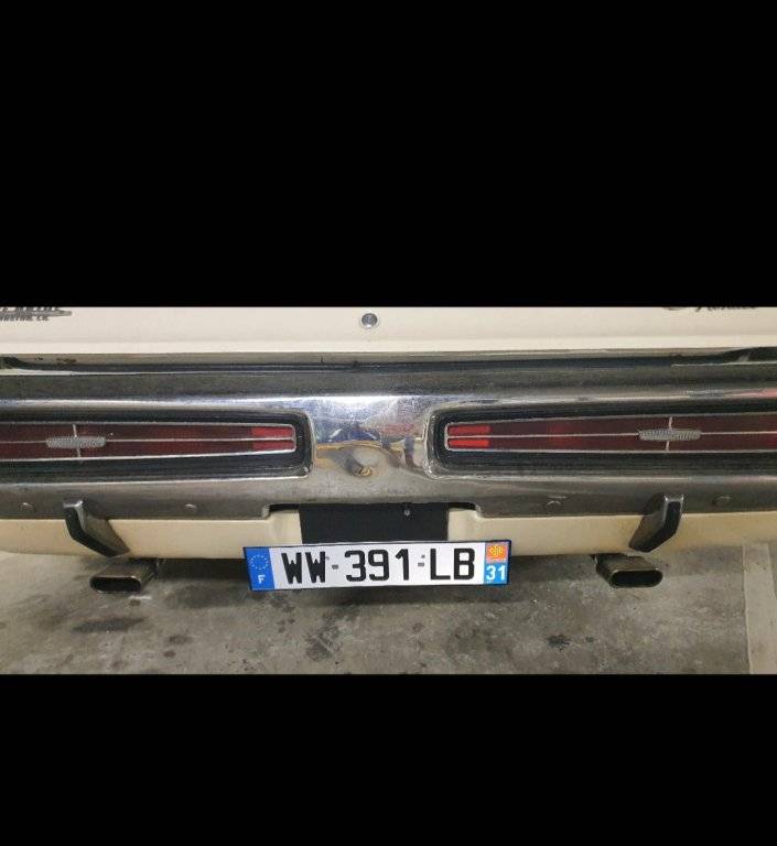

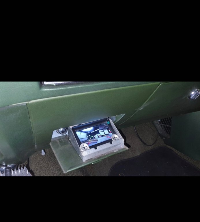

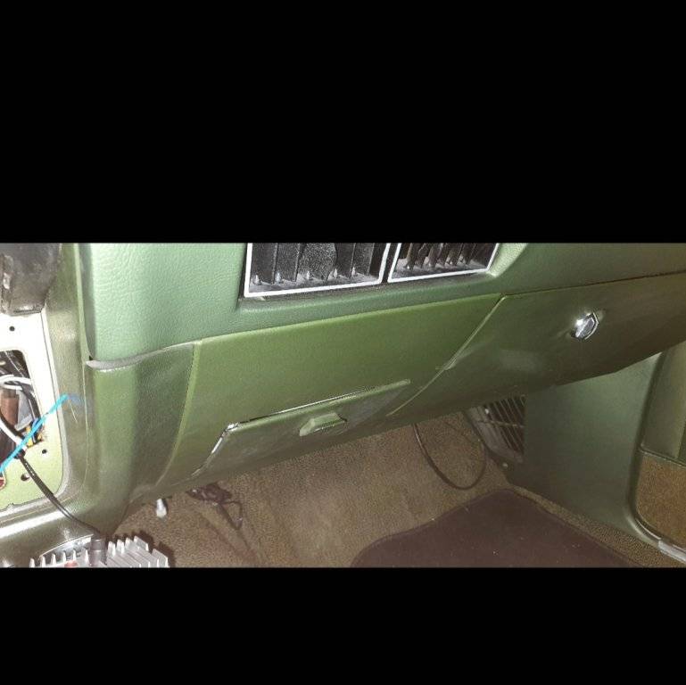

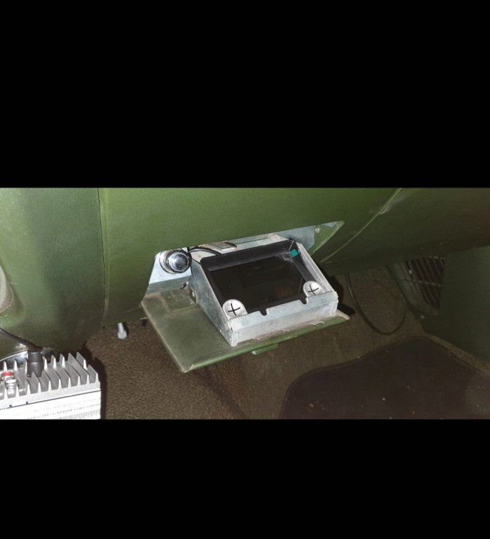

Hi,
I saw this kit on aliexpress and for the price..
I just received it today and installed it in less than 1 hour.
It is a hijack but it works :
+12v to power the rear camera from the rear light ( violet cable ) and ground on the body
+ 12v on front to power the screen on the same cable in the connector next to parking.cable and ground on the body.
You get in the kit 6m of linkage, perfect.
And the best, the screen just fot inside the ashtray !
The screen powers it self when you pass on rear of course.

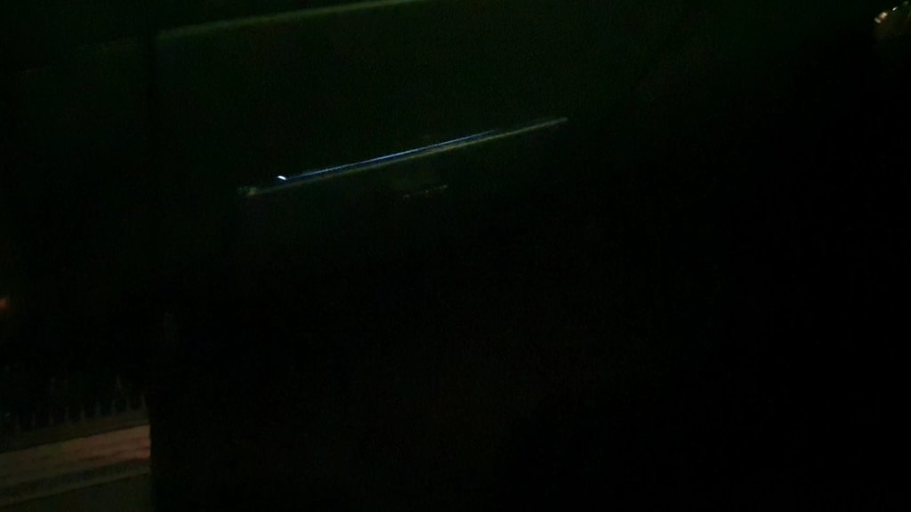

Sorry the pics are dark.
You open the ashtray and pit the rear, the screen is on.
When closed you see nothing ( the screen was still on because i was syill on rear ).
