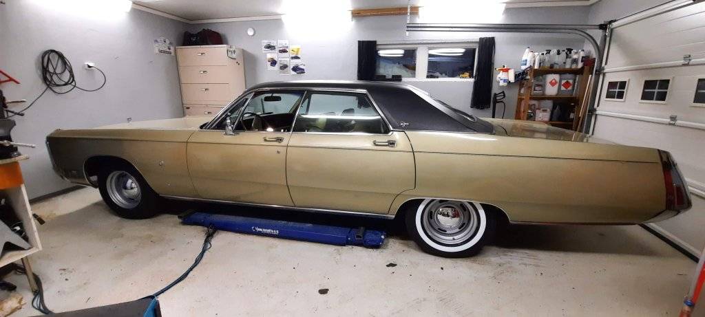

Never say never, but I don't think this will be a restoration project, not during my time at least. It's too good for that - or good enough to keep it like it is, how ever you like to put it. First I didn't like the dull and sloppy paint job it has and was already planning to have it painted some day with the original gold color. But then again, it has been painted in the 70's, so it's already part of the car's history, which you would loose, there is no rust and it looks ok from a distance, plus I don't even want to think the cost of a decent paint job for a car this size. Just had my '93 GMC Typhoon painted and it costed pretty much the same as I have put money in the Imperial, including the purchase price, shipping, taxes, everything... And it's only half of the size of an Imperial.

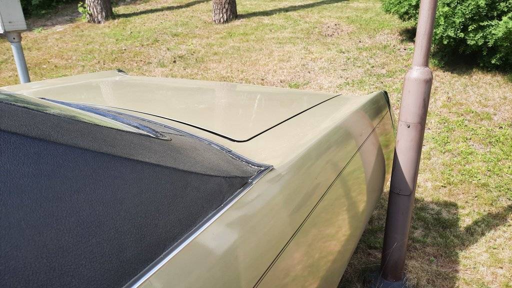

Also having a car that is not show class lowers your stress levels, you don't need to spend sleepless nights after every small scratch. Speaking of which, I had a close call last summer when I took the Imperial to work and tried to squeeze it to the tiny parking space, avoiding hitting other cars and especially the heater post on the right hand side of the car as I only have the driver's side mirror. And when I got out of the car, this was on that side. :eek:

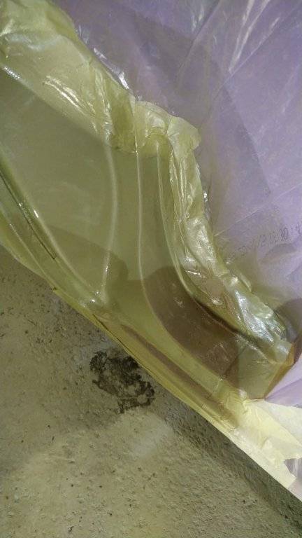

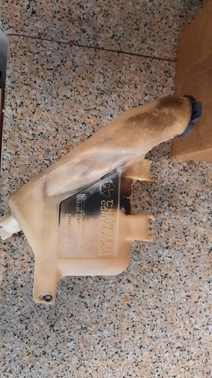

I tried to fix the leaking washer fluid reservoir but no luck, it was so brittle that you could hear it fall into pieces if you even looked at it. But I got a solid one from Furyfinn, it had gotten some overspray probably from an earlier engine bay "restoration" project. I didn't want to use any solvents on it but soda blasting cleaned it pretty good, not too bright to fit the rest of the patina around it. In the photo I have cleaned just half of it for comparison.

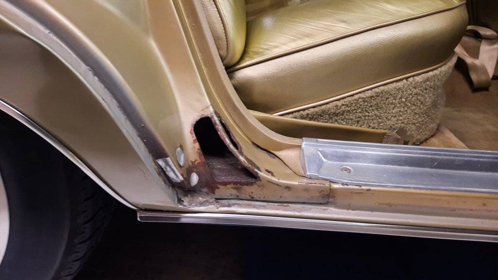

Some very strange rust holes (the only ones found so far) at the right rear door were fixed by my friend, it seemed that there was a small hole in the wheel well which had let the mud and salt get into the housing behind it. After that the car was good enough for the Finnish veteran vehicle registration. There was an absolutely mint Renault Alpine to be inspected at the same time as my Imperial, wouldn't mind having one!

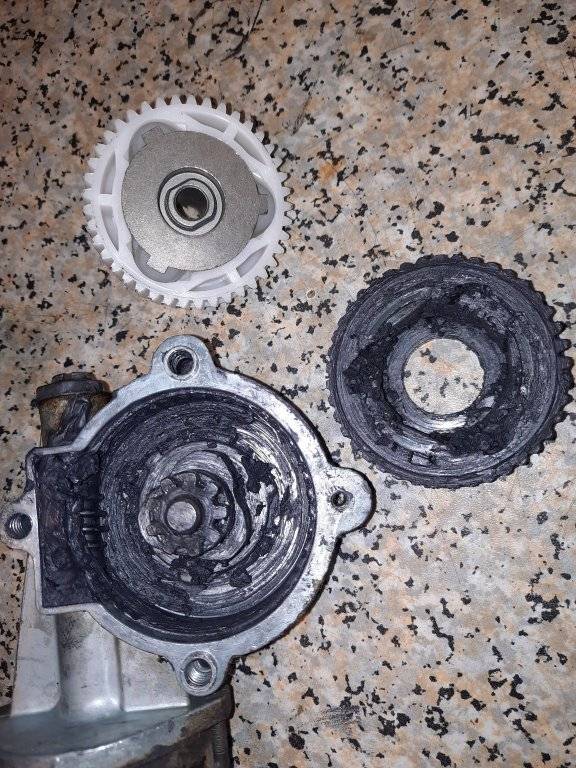

The headlamp doors didn't always shut when turning off the lights, but did shut by just slightly rotating the manual wheel. At one point they stopped opening as well, so I took the gear and the contactor arrangement open and managed to get them working again - for a while. Soon the movement started to be very low, but some lubrication for the motor helped. Now they stop a few mm before they are properly closed and there seems not to be any adjustment for that, but I think it can be solved by twisting the operating bar a bit. Or opening the gear fitting holes a bit so I can rotate the whole assembly.

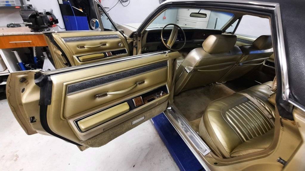

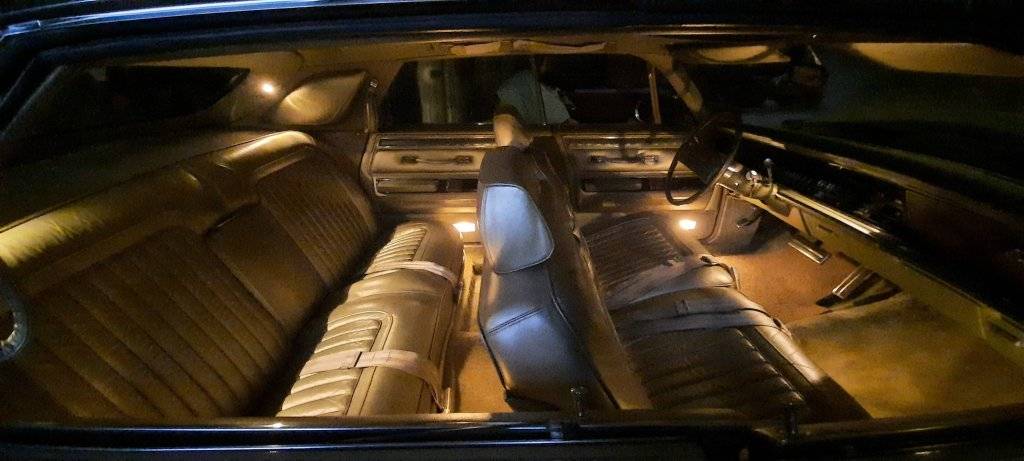

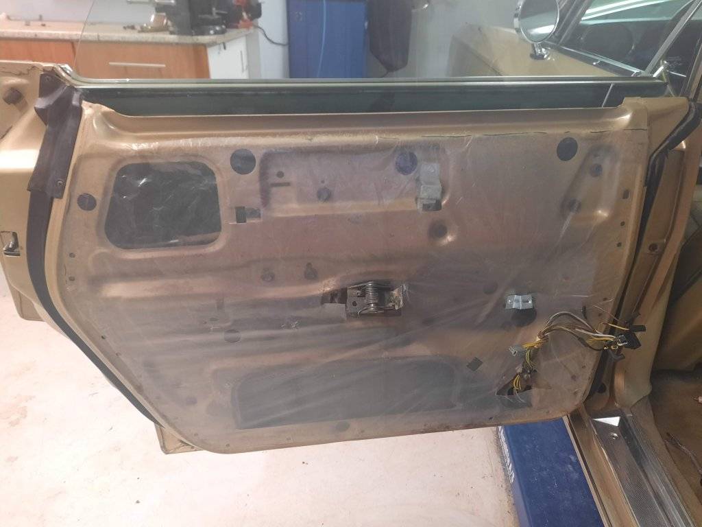

I've taken all the doors apart now, the left rear being the latest. Each one had some issues with windows and/or central locking, but this one and the front vent windows were the only ones requiring new parts. A new gear assembly for the motor in this case. Now I can fully enjoy the best features of a 4 door hard top! Also central locking and all 6 windows work as the are supposed to.
