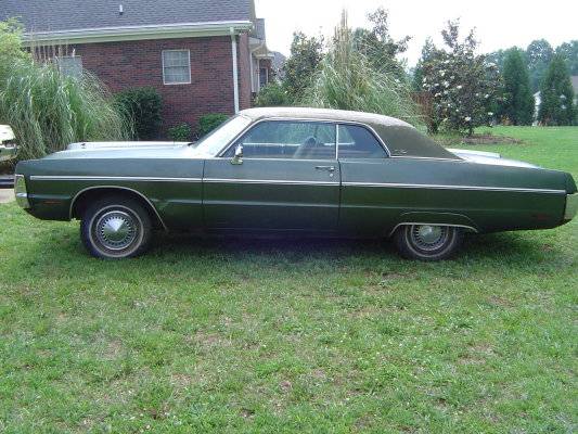

71 Gran Fury

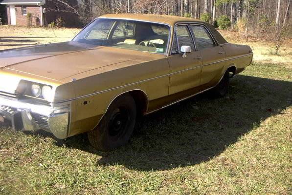

73 dodge Monaco:

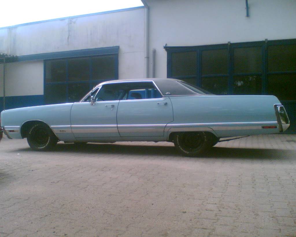

Nice! I'm really diggin the 4 door hardtop:happy7:

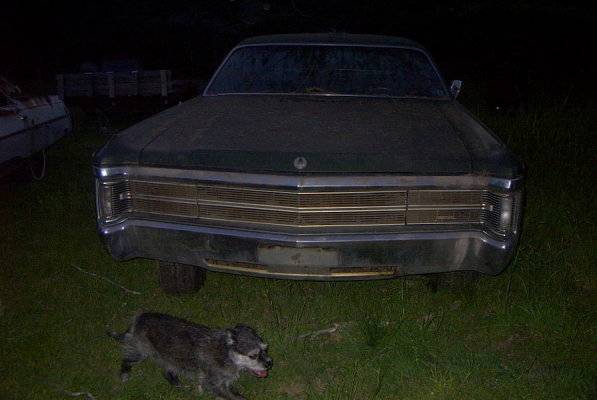

Judging by the "I`ve" you don`t have these anymore? Too bad I could really use that rear bumper on the `69 Imperial. I`ve got 2 and there both bent:BangHead:
I know longer have any of those cars. The Imperial is sitting in Ohio now.

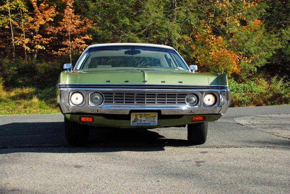

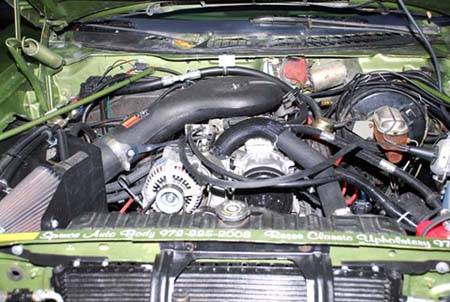

Here is Polaraco. The car was done almost 4 years ago and is my daily driver. These pics are a bit old, 3 years. It had a 5.2 Magnum replaced with a 5.9, built for torque and MPG. (18 around town so far) It's main features are a fuel injected 5.9 Magnum and a 518 trans. Custom interior, with a partial digital dash, power windows and delay wipers. 72 Monaco rear bumper too. Next summer it is getting a 77 Newpie Dash ac/heater setup. Modifications to the firewall will clean up the engine compartment. It's going to get a complete rewiring job too. Reduce some wiring in there. CBarge has driven it.
Yeah, I agree, gorgeous car and sweet under the hood.....looks terrific!
I recently made it sweeter. Thanks for the compliment. That last engine shot was from 4 years ago. I was sucking too much hot air with that set up so I plumbed the air out ahead of the rad support. MUCH better.
This is what it looks like now. I'm getting it ready to install turbos. That's the 5.9 Magnum I built for it last year. The previous motor was a 5.2 magnum. The 518 trans gives me 25 MPG on the highway and 18 around town
