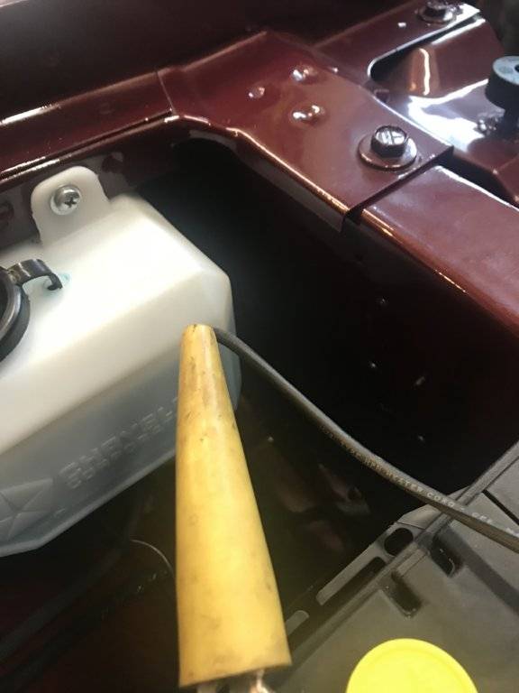

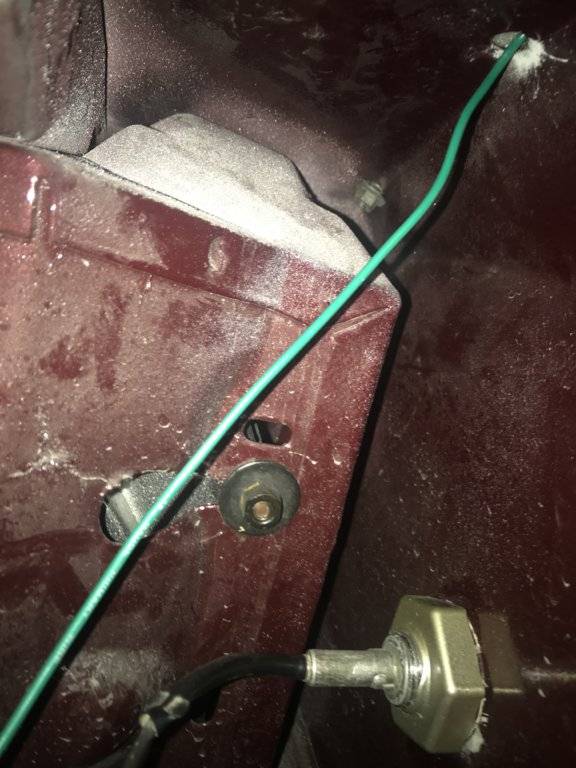

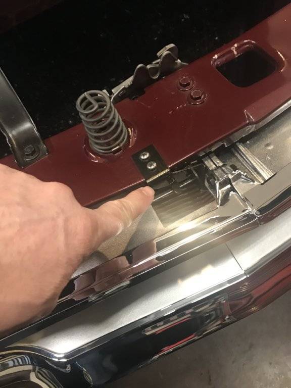

Sorry to say they are mostly right.
If some how some way you were able to get a small wrench or ratchet on the front retainer to loosen, you may be able to swing it enough to get the bulb from the bottom side. However it is very likely you will break the pin off.
Soo... your best bet is to remove the grill to access the front stud retainer to remove the assembly.

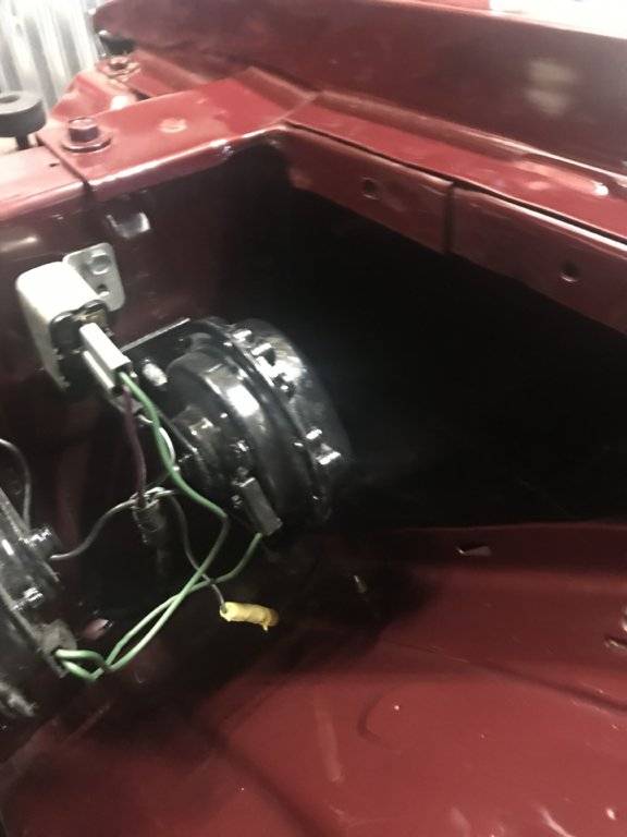

As a follow-up question, does this mean I then have to disassemble the rotating headlight covers too? I can't quick figure out if that is independent from the grille.
On my Polara they are screwed to the grill. Should be able to leave the headlights alone as well.
On my grill there are 4 nuts on each end and two center support bolts. You will have to take your hood release lever off. (Unless you have an internal one). Unhook your headlight wires and the whole grill should pull out.
May have to remove your washer bottle to get to the LH nuts.
Getting to those nut was not such an easy task for me (fuel injection and electronic ignition parts in the way). But... after removing the fender light housing at the top, I was able to see I could get some access from the bottom of the fender. So I unplugged the wire and disconnected the ground, then taped some twine to the end of the wire (like an electrician's fish tape). Carefully lowered the old light through the opening in the bottom of the fender with this twine in tow. Taped the twine hanging out of the bottom of the fender to the wires of the new lights (thanks again Murray Park), then pulled the twine back and fished the wires through ht hole in the fender extension.
Climbed under the fender and pushed the light up through the fender extension slot. Rested them on the plastic insert, reattached the housing, and Presto! Fender turn signal indicators are up and running.
