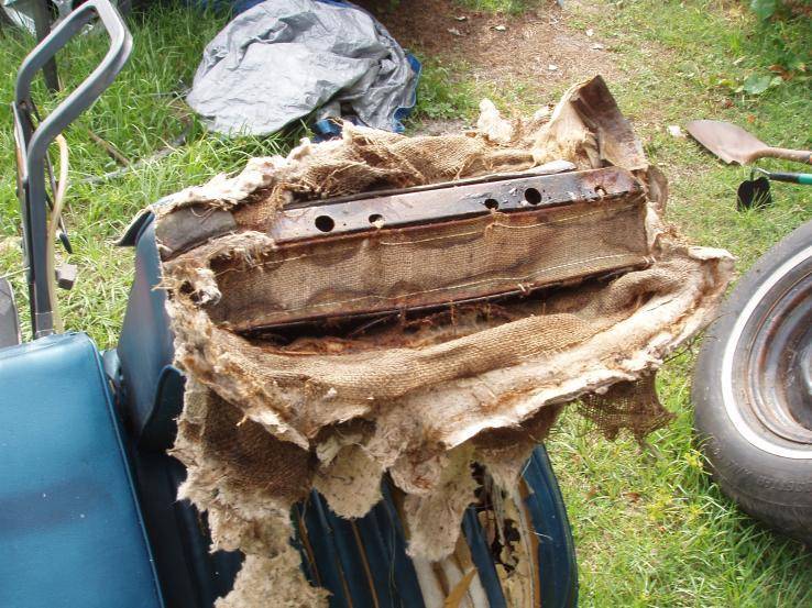

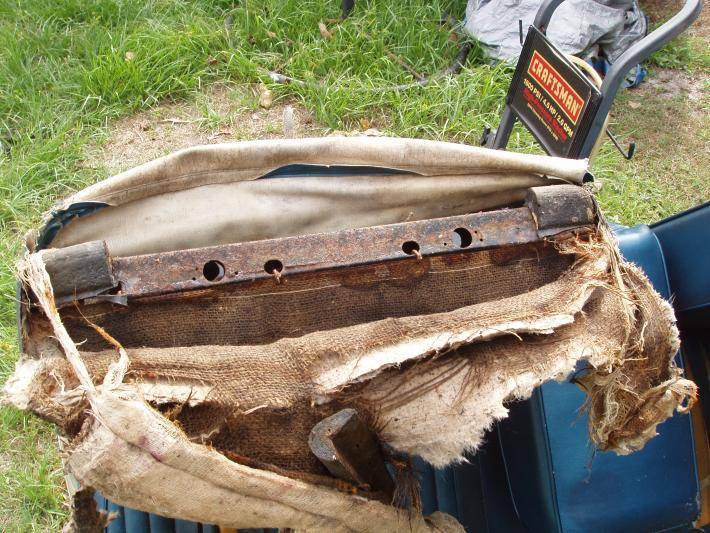

i had front 3 point belts installed in my 68 sport suburban wagon by the shop that did my rust repair. i bought them for seatbeltsplus.com for like $79.00 each. they came with all mounting hardware. they came with mounting plates with nuts welded to them for the b pillar. the shop drilled a hole in the sheetmetal and reversed the plate putting the nut in the hole and then welded the plate to the b pillar and mounted the upper point to it. kit also came with floor reinforcement plates. work great and wife says shee feels a lot safer riding in the car now.
Any idea if my '67 with full bench would have these holes?
Are there tubes in those holes for the headrest to slide down into?
