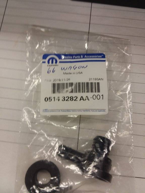

I ordred this for my 66 fury wagon power brake groument and check valve
And it fits perfect.
From the mopar dealer
See pics for #
