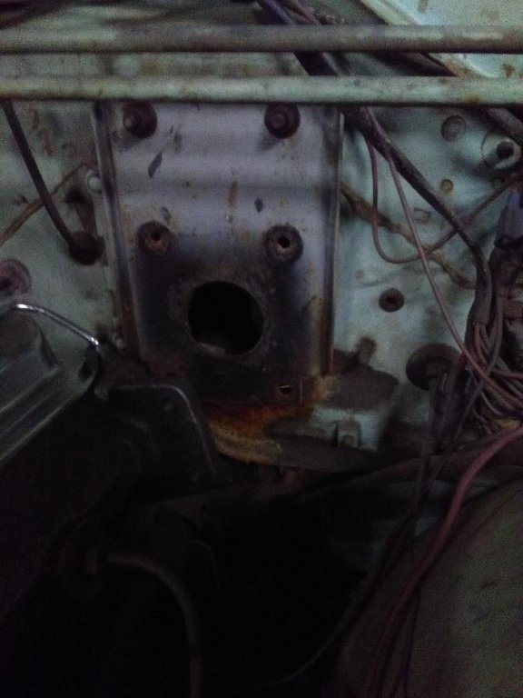

The back plate and pedal assembly are different...here you can see the 4 holes where the booster bolts on
