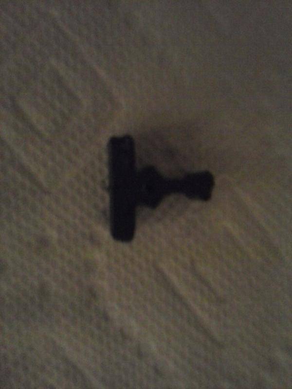

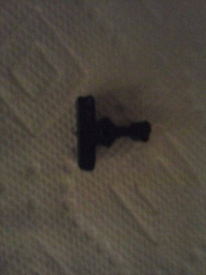

Just an update, I received my parts from Gary Goers today and I mailed in my order on 11/7, so that was pretty quick! I only ordered about 4 items so it was a small order, but still I was expecting a longer wait, so that was a nice surprise! I could see how most cars lost the power steering pump bumper it's pretty small. I guess it installs in the bracket according to my manual, they're must be a slot it fits in. I'll look at it on Saturday, it's way too cold out today! 2014-11-17 16.38.32.jpg
