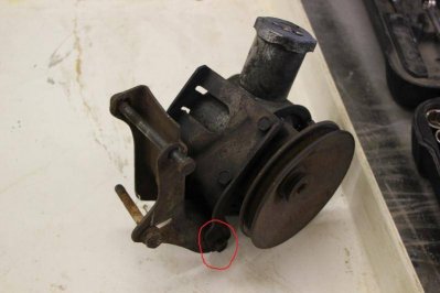

I had the power steering system rebuilt and have mounted the pump, but I am missing something when tightening the pump. There are three bolts 2 I can tighten down, but not the special one is which, only threaded on the last inch.
The way it is now it now it pivots on that bolt so I can't tighten the belt. What am I missing? Just a flat washer?
Also do a just use regular power steering fluid?
Here is a pre-rebuild pump with the bolt in question.

That looks alot like the TRW pump I have as well. That bolt never really got tight for me either, I tried the washer trick to make up for the gap but still didn't totally correct it. The best way to go is a new upgraded bracket to work with that pump or a whole different pump/bracket setup. I went with a new upgraded bracket. I think others switch over the the Federal style pump which I've heard performs better as well.

My 67 has the style in your pic.
A real PITA trying to tighten the PS belt.

Yep, those early federal setups use primarily gravity to maintain belt tension. The pump hangs out over/past the pivot and isn't designed to be tightened to hold the belt tight.

I can grab the pump and move it no problem. Enough to take the belt off, so I thought it was just supposed to be that way. I've never had any problems with the pump on my 1968 440ci.

I kind of thought this might be the case because of the design of the pivot bolt. It moves very freely now that the dirt and grime has been removed. I guess I won't worry about it at this point. I will see if there is any issues, once I start the engine for the first time.

I know this is an older post, but I'm having the same issue, I guess it's a common problem. The rubber wedge piece on mine must be missing from what I've read. I tightened the bottom bolt on the pump bracket and the pumps still loose, I even put some washers on before the nut and that made no difference. I've read that Gary Goers sells these rubber pieces or would it be better to buy the updated bracket?

Thanks for the replies, I'm glad it wasn't just me because I couldn't figure it out until I did some searching on here. For now I just wedged a piece of heater hose in the bracket and it seems to be working until I can fix it properly. I probably will order some parts from Gary over the winter.
