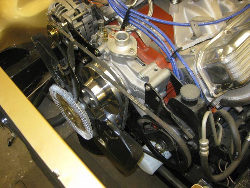

I converted my '66 from the old Federal pump to Saginaw by combing junkyards for a compatible bracket setup from an '69 thru early 70s big-block car (doesn't have to be a C-body). My '69 Coronet R/T had exactly the setup I wanted as factory-issue, so I just duplicated it. There's another layout that positions the pump to share a belt with the fan and reduces your belt count from 4 to 3 (assuming AC so you have a matched pair turning the alternator and compressor), but that requires your engine to have a drilled boss that I guarantee you a 361 won't have. :p
Saginaw installation visible here:

I did the Saginaw conversion on mine as well, using the belt-over-fan-pulley mentioned by 440 Magnum. As can be seen in the photo, The drilled bosses mentioned aren't needed.IMG_3212.jpg
perfect, thanks for the pics, I am new to this car and mopar so learning.
John.
I did the Saginaw conversion on mine as well, using the belt-over-fan-pulley mentioned by 440 Magnum. As can be seen in the photo, The drilled bosses mentioned aren't needed.View attachment 66078
I should have been clearer: the boss (its on the front face of the block near the oil pump) is needed when you have AC and the fan belt is forward of the paired belts.
There are few thing on Mopars that change seemingly randomly from model-to-model and year-to-year... but belt routing and accessory mounting is one of those things. Endless permutations.
