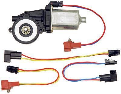

WARNING! WARNING!Dorman 742-300 for the left side and 742-301 for the right side. Front and rear use the same motor. They don't show it for your car but Mopar used the same window motors up into the 90's. The only difference is usually the electrical plug (the Dorman one I listed comes with adapters) and some have support brackets and some don't. The Dorman motors are much smaller/lighter so if yours have a bracket, you won't need it.
Autozone and Summit list them for $39. Advance wants $75. Thinking that must be a typo.

These motors are brand new and are complete. I have a set. The motors also don't resemble the originals appearance wise.
KevinView attachment 71772
Where did you buy yours? Did they have the correct pigtail?
My 300/301's from RA came naked, as well as the ones from AZ.
F#$&. I cant remember. Lol. I'll have to check when I go out to the shop.Were the motors original style Stan, or the Denso type I posted?
Kevin
I only benchtested them, obviously ;) But they are working flawlessly!caught that piece in your build thread...how are they working?
I think the refurbished OEM-style units come without gears, like this one. The newer non-OEM-looking motors come with gears, allegedly "ready to install".F#$&. I cant remember. Lol. I'll have to check when I go out to the shop.
You were correct. I got the refurbs...I think the refurbished OEM-style units come without gears, like this one. The newer non-OEM-looking motors come with gears, allegedly "ready to install".
