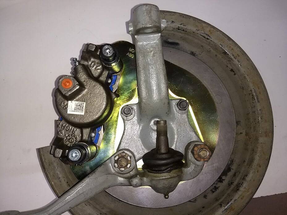

scarebird
From what I've read, Scarebird is a good name for that company, especially the "scare" part.
They do get some conversions right, but I've read some stories about their stuff not being robust enough. I looked over a few of their offerings and quite frankly, I didn't like the designs on some. Mainly, the mounting bracket being a bit too thin with things like a 3/8" bolt threaded into a 1/4" plate. Someone here had brackets that cracked too. (can't remember the screen name).
Some guys have had good luck and that's great.... Just telling what I've read and seen.
