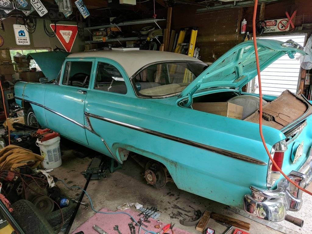

So, not a Mopar but my girlfriend's Dad's old car. Its a 1956 Mercury Medalist 2 door post car.
He died when she was 12 and wants to have this on the road for her Uncle's 50th wedding anniversary in a couple of weeks. I'm doing brakes all around as it's never had then in the time I've known Laura and her car. Got wheel cylinders and tracked down some drums.
The car had a GM 4Jet carb on it with modified linkage to make it work. Got a different intake with the correct Holley 4000 "teapot" carb, freshly rebuilt, used then taken off and sold to me. Tried mounting it on the intake on the car but they plugged all the holes needed so I got a gasket set and put the cleaner intake on. When I went to drain the radiator, only a quart or so came out! Nobody has done anything to this car for years. It always ran fine when we started it, but the longest drive was 10 miles. Then when I took the thermostat housing off, found out there wasn't a thermostat! Maybe years ago when they were having overheating issues, they took out the stat and forgot to fill up the coolant?

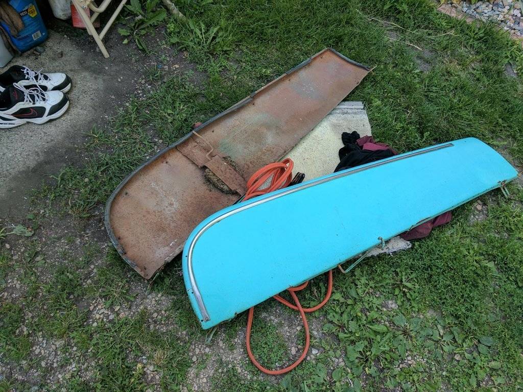

Her Dad put on fender skirts from who knows where or what. They will be going back on the car. It's been repainted to a turquoise color, was originally a medium green.

Got the shoes and wheel cylinders replaced and the rear drums turned and installed. Getting the fronts back tomorrow with new bearings and seals. Have to replace master cylinder in the morning along with the fuel/vacuum pump, route some vacuum lines and bleed the brakes Thursday, then I have Friday to tweak little things.
Hey! Those are cruiser skirts. Totally bitchin'.
Laura probably wouldn't let me put on a set of factory skirts, or the correct mirrors. That's cool, I want her to have the car how she knows it.

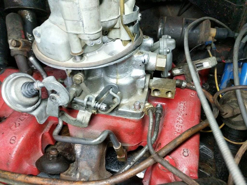

So, the port on the back bottom side of this Holley 4000 teapot carb, is it full vacuum, or is it ported?
That brass fitting is the port I'm asking about. Thanks folks!
Dunno for sure, but I'd bet it's full on from the looks of things. Are you having fun yet?
It's full, fun, I'm sweating away the pounds! Conditions me for work, really,what a benefit.

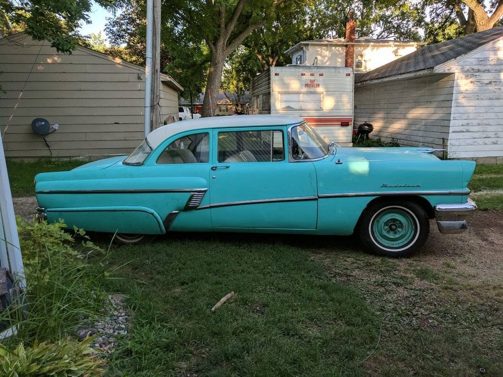

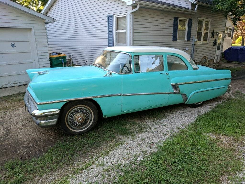

Well we made the deadline, a couple hours later than I wanted to, but we still made it. Lost a hub cap a couple miles from our destination, I went back and walked the ditch and found it, you can see my car way off in the distance, I only had to go 1/4 of the ditch thankfully. The car drove well, although we didn't have brake lights and the right from signal wasn't working, love living in the country! Brakes were good and the carb worked flawlessly. Engine kept cool, so it all worked out. Here's a couple of pics of the car.
Gotta put that hub cap back on, replace the emblem I broke, and figure out how the trim clips work so I can get it tight, got a couple pieces kind of "hanging" on. It was something different.
