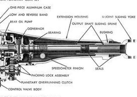

I can't seem to find a replacement for what I have..any ideas?
- barrel diameter: 1.680"
- bearing cup diameter: 1.070"
- u joint width: 2.125"
- length to center line of cap: 7.4375"...the closest I found matches all above dimensions except the length is longer at 8.03".
Thank you
