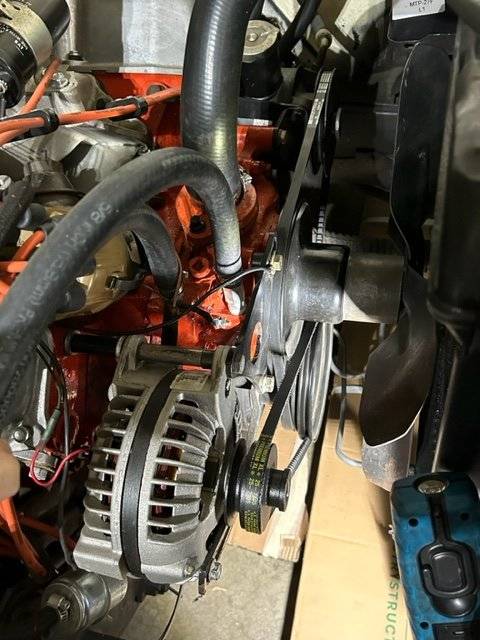

Looking for some advice on pulley alignment. I did an engine swap in my 1965 Plymouth Sport Fury from a Poly 318 to a 1968 383. The 383 did not include all the bracketry so I have a mixed bag on the pulleys and brackets. In order to make it work, I spaced out the alternator bracket to hit the second groove on the pulleys, power steering uses the first groove. My goal is to remove the alternator spacers and get it aligned properly.

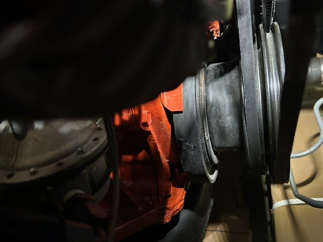

The pictures show the installed alignment and a comparison of the 2 and 3 groove pulley dimensions. I think the 3 groove will stand off less from the crank and when the spacers are removed from the alternator it should line up? The car does not need the 3 groove pulley and it is heavier than the 2 groove. I found on ebay a 1965 318 Poly 2 groove pulley that looks about the same stand-off dimension as the 3-groove but not sure it will bolt to the crank. Does anyone know:
