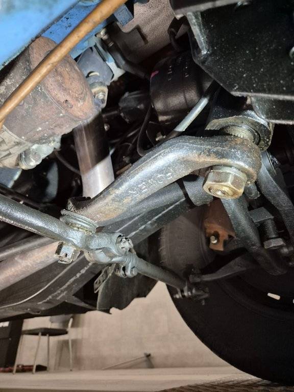

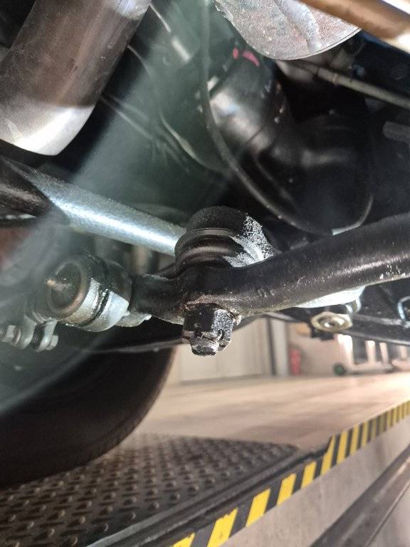

Small update. I visited the national safety vehicle inspection center.
They test the wheel drag on powered rollers, brake effectiveness and if equal on both sides. Everything perfect. So the next step was the shake and pull test of suspension and steering componets. All was tight , except one item - the pitman arm. There is a lot of play where the pitman joins the center link. From all the loosenes, the nut also came loose, and the whole thing was held on by the safety pin (i guess the engineers knew what they were doing ;) . Tightened it up, and waiting on a new pitman arm from PST -on backorder :(
With the linkage being very close to the drivers side control arm, i guess that's why it had a constant tendency to pull to the left...
Glad you did those tests. Glad you found a bad part. Sometimes it's just one thing wrong makes it drive bad.
It doesn't matter how close it is to the control arm. If anything in the steering is loose it will change the toe at the tires and make it drive wrong.
