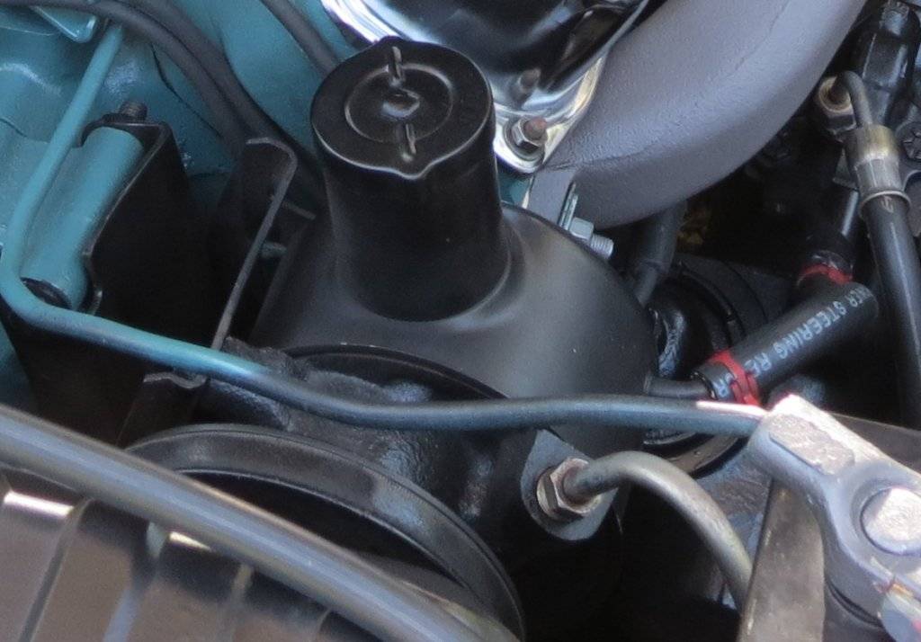

Looking at your PS pump position it appears to be adjusted way out. Here’s a pic of mine, you can see the difference. When adjusted correctly it won’t touch the fan pulley statically but will very lightly touch it when running as the belt shakes. It should be silent with no squeaks. I suspect you have the wrong crank and possibly fan pulley. A look at the parts books shows these as the right parts-
Crank pulley- 1826053
Fan pulley- 1821452
Fan pulley- 1821452

John, The pullies I was using were the one supplied in the Kit from Bou........, I have no problem when I put the ac pulleys back on. What I need are big bock pulleys from a car w/o ac. Those are not easy to find in good condition. Thanks for the time mike
Fan pulley- 1821452

so John, What year pulley are those? The 440 source crank pulleys says "use for Saginaw ps replacement" mike
