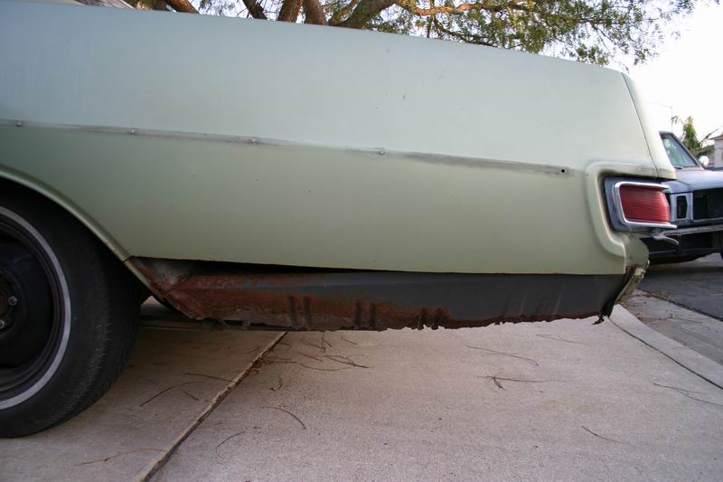

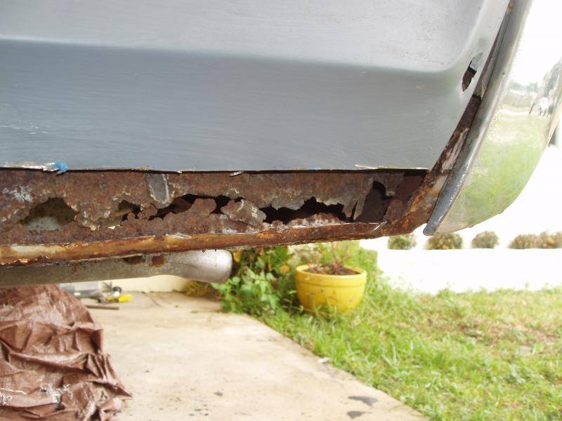

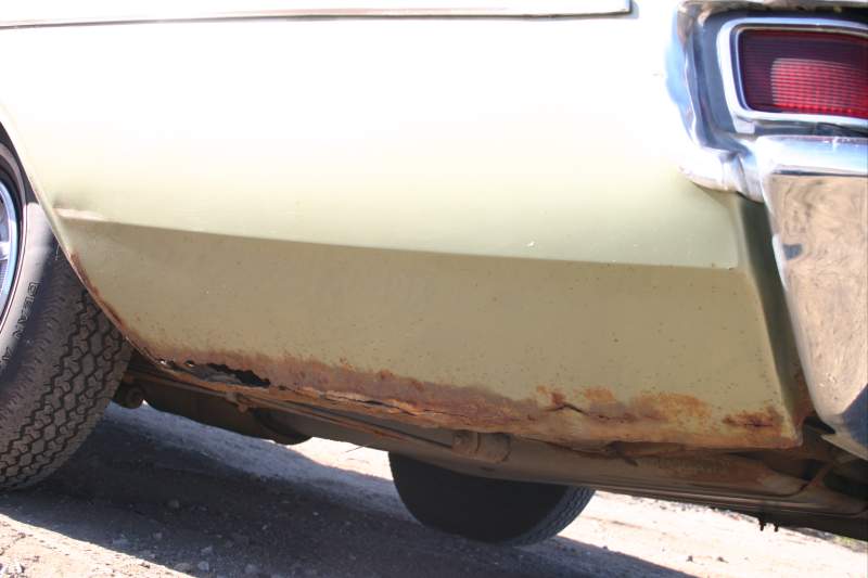

I am still looking for a LR quarter panel for my 68 Newport. I could use all the help I can. If I can't find a decent one I'll have to bend a lot of metal.

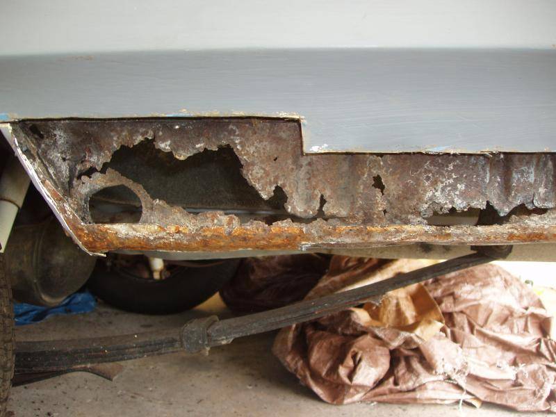

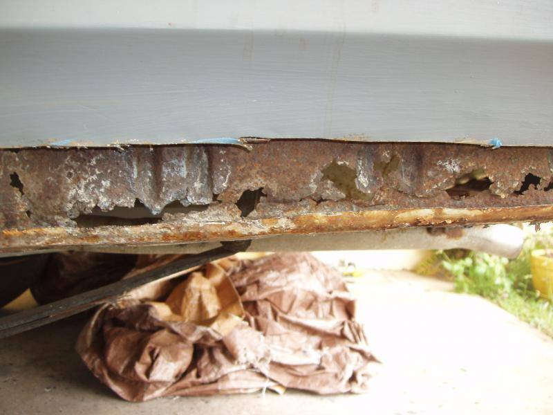

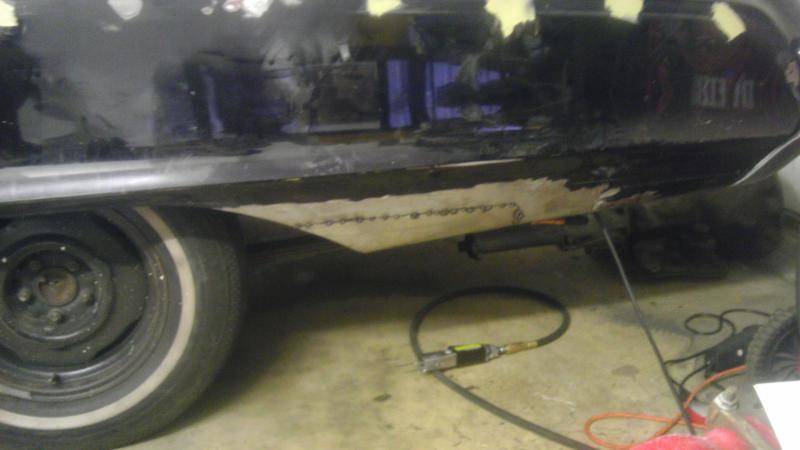

You're replacing the entire thing? I thought you just had typical rust behind the rear tire?
I don't think this is typical rust. newport 039.jpgnewport 040.jpgnewport 041.jpg
Yeah it isn't that bad. Still well below the lower body line.

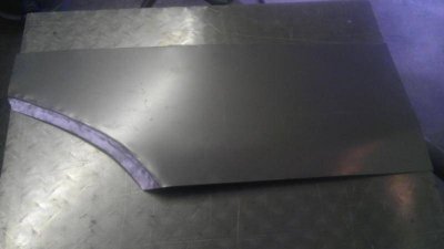

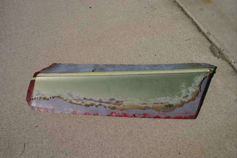

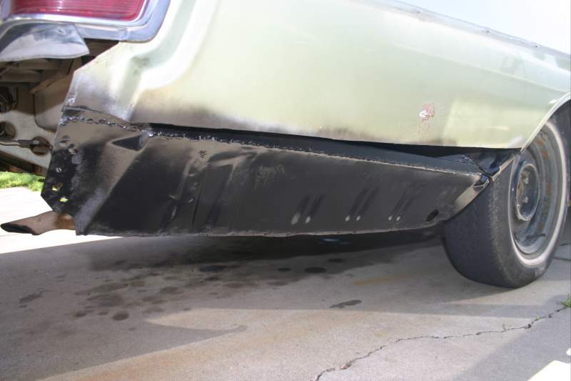

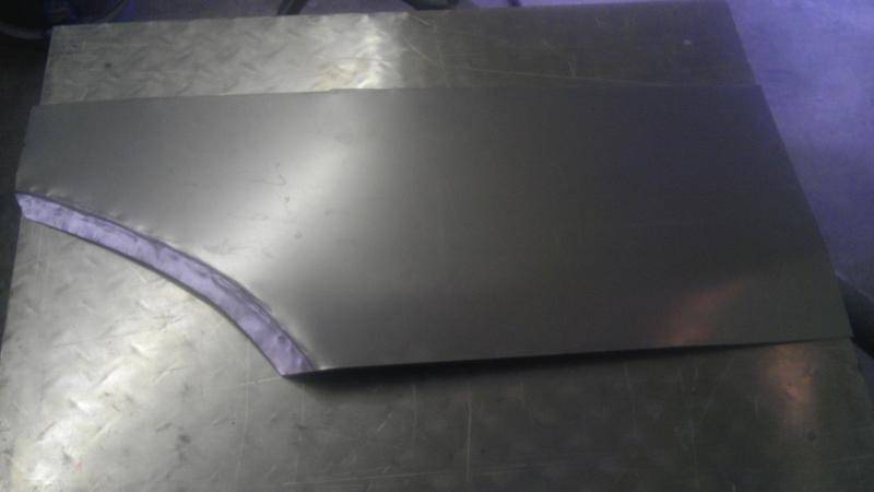

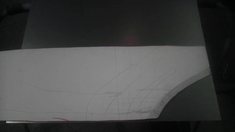

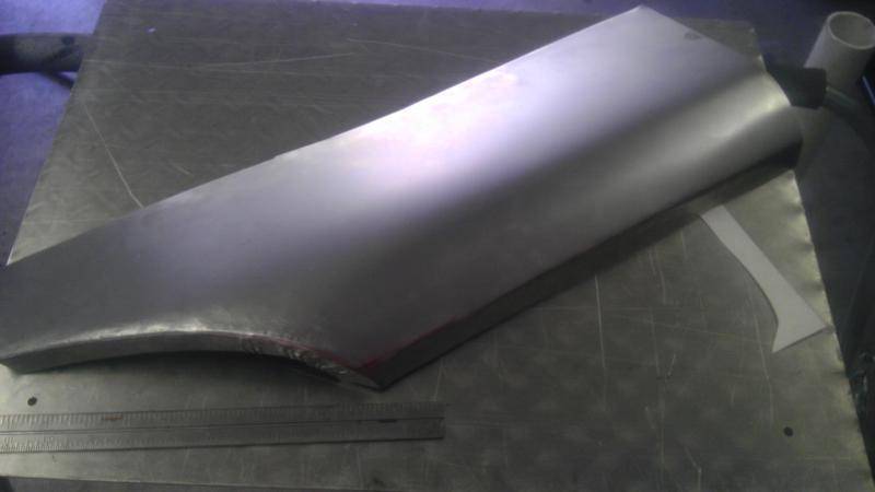

This is what i did on a similar patch;
All I had was snips, needle nose pliers to form the tucks, hammer and dolly set. Wasn't all that bad. Your situation and skill set just requires a couple patches rather than just one big one.
And, ordering a quarter panel still won't get you the trunk extension you need. you'll either have to cut that out of a donar car or make it yourself. and if you make it yourself, you may as well shoot for the outer skin too.
Damn that looks good. I can make the outer panel pieces. It's the inner structure pieces I'm worried about. I guess it just takes time. Thanks for the help. By the way, should I cut a bigger opening to get to the innards, and then re weld the panel on?

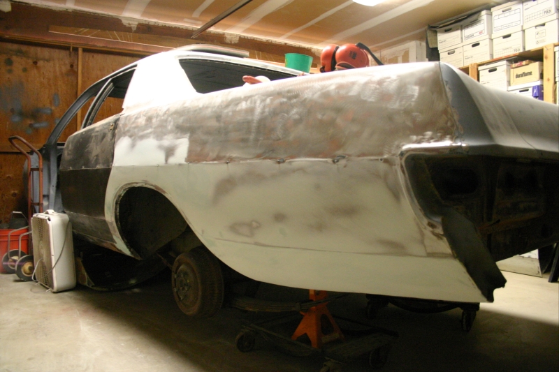

The inner piece is the easy one if you do not care about the factory bumps. The outer we cut from the upper portion of a front fender.
Different car...
Sometime you just need to get creative on what you make your patches from.
Inner structure last. You'll need the access to plannish the weld on the body panel.
Oh and the final pic was actually the second patch welded in third patch made. First patch panel wasn't worth attaching, second patch came out great but welded and cleaned up like crap due to bad fit up, third patch had the proper look and fit up was much tighter. So don't think I can pull off a patch one off out of my arse... I get lucky, but I create that luck by not giving up.
How did you get in to weld the inner structure when you welded the outer panel first?
Also, let's say you want to form the roll of the patch panel from the flange. You make your flange on the patch however you do it, hammer and dolly, pliers, adjstable wrench, flanging tool etc.. Then you form your tucks in the flange, this will give you the curve you're looking for. Take a look at this video, at about 40-50 seconds he takes his metal to a pair of tucking forks, think needle nose pliers, he twists the metal rather than the pliers but the effect is the same a tuck is formed and the piece bows. Think if you had the rest of your panel with the flange and you did the same thing, you'd have curved the entire piece. Yes you have to hammer the tucks flat essentially shrinking the metal, yes some curve will come out of it, yes you will have to keep tucking and shrinking until you get the shape you want.
