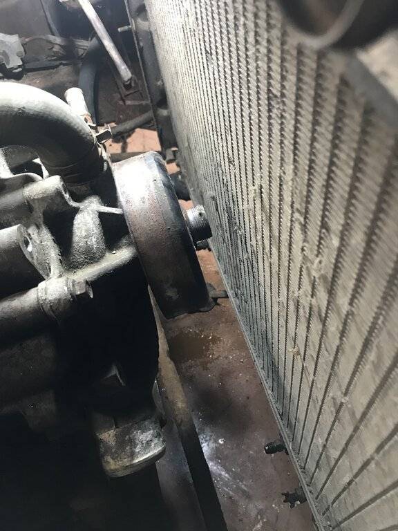

Was thinking since it has a new rad already id just run a dual electric fan setup and rid the old mechanical fan off the V10. Slimmer and makes more room. If I can remove the shroud and fan off of a 400 big block and keep it at 190 (fan is on rn tho btw) then I believe that rad will keep a V10 welp cool

If you plan on running the V10 and want to keep the radiator in the stock location you will need to put the fans in front of he radiator.

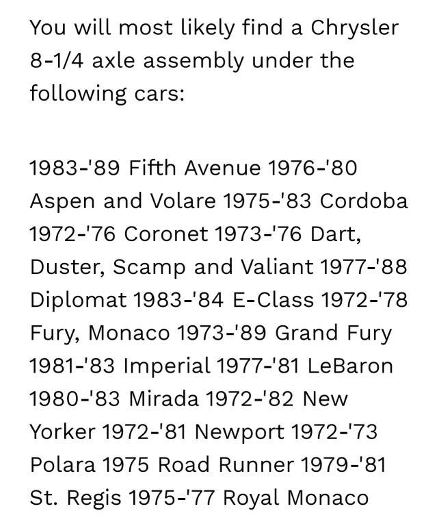

I'd be very surprised if you have an 8 1/4, but I also hope you do because that could explain an axle going bad behind a 400 that can do a 20 foot burn out. 8 1/4 can't handle that. This would be the first I've heard of an 8 1/4 behind a big block. Could also be a replacement that someone slapped on the car.

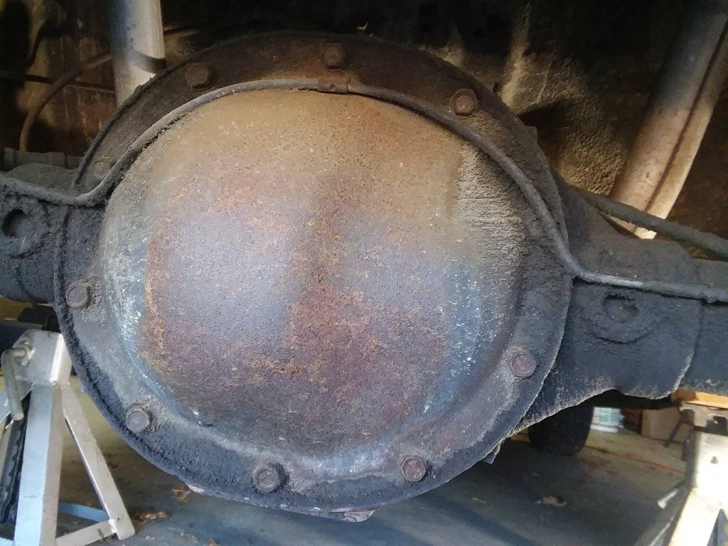

If it looks like this and has same number of bolts, it's 8 1/4. I'm hoping it's the axle and not the trans. Ben
I have a pic of the axle buried in my phone somewhere or a video of it
Edit: actually I dont so ill peep tomorrow at it
As I recall, both the 8.25 and 9.25 axles are Spicer products. The 8.25 being a "10 bolt" and the 9.25 being a "12 bolt", as mentioned above. Kind of hate to see "Brand X" terminology applied to Chrysler Corp parts! In some cases, the 9.25 has been mistaken for a Dana 60 at first glance.
I'm not denying the 8 1/4 axle was in c-body cars
I had 8 1/4 in 1970 Fury 318/904.
I had 8 1/4 in 1972 Fury 360/727
I have 8 1/4 in 1973 Dodge Monaco 360/727.
My point was: you have a 400 big block and I did not think 8 1/4 went behind big blocks from the factory.
If you have 8 1/4 on your Newport and the date code on the ring gear match YMM of your car, shrug, I'm wrong. Won't be the first time.

Just in cast you pull the axle cover and the internals are trashed:
