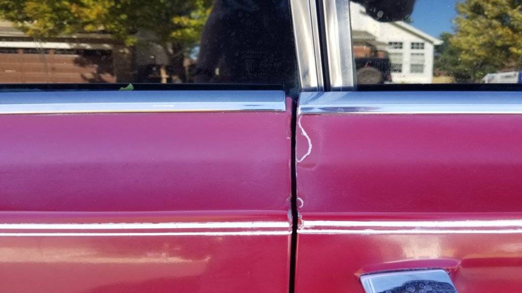

I have a very long deep scratch on the side from previous owner. Almost looks keyed but was from a Bush on his driveway. Hard to see in pic but clear as day up close. Should I sand it and Bondo there? Or would layers of printer and paint work? The car could use a new paint job but is serviceable for now.

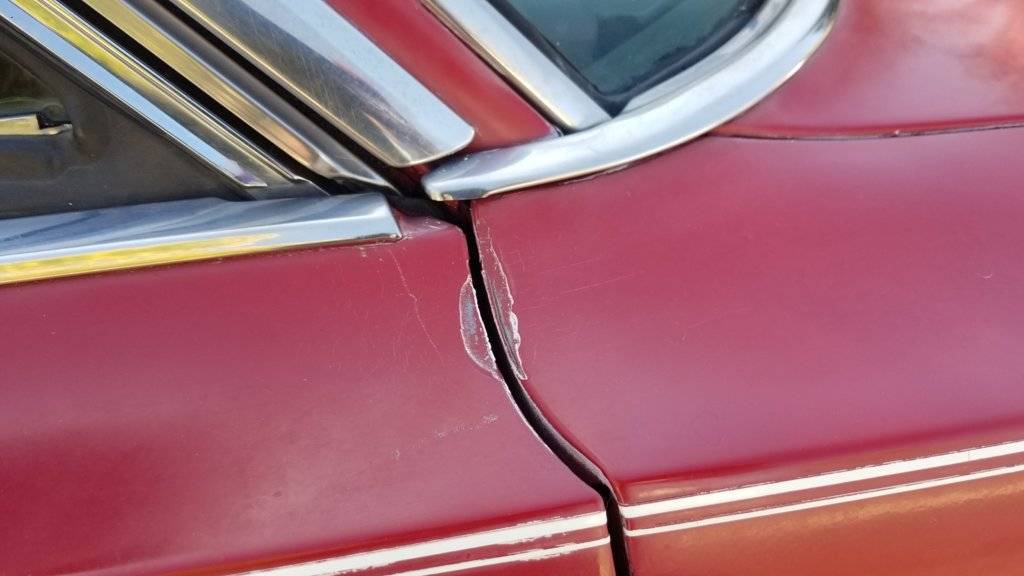

And last there are some deep chips broken off around the door frames, and trunk. Would I just mold Bondo there and sand?

Yes, it was repainted years ago from previous owner. Under the hood looks a little burnt orange. Makes sense about the hood. Would you suggest Bondo on the door chips? I don't want any chips.
Pick a scab and it will bleed....
Again,sande down,build it up and blow in new paint to blend.
The repair areas will be double or triple the size of the chips now.
If you just want to fill them on,use touch up paint or nail polish.
To be honest, you have enough paint damage that may warrant a full repaint if you want it done right the first time.
Yet I can inderstand that can be expensive to do.
I guess my ultimate goal is to repair it for a future repaint. The paint is super thick. If I do a full repaint correctly will the car need to be sanded down to bare metal to fix all these chips? My thought was I fix (fill) these and get the chips smoothed out and then get it painted. If car needs to be sanded down anyways then my thought process changes about filling in these chips and I'll just keep them protected from rust until then.
In that case,use a spot putty not bondo to fill in the chips.
Build them up and smooth out.
Hope this helps.
