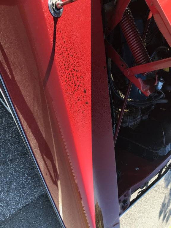

--> Are you thinking about the possibility of a leaky head gasket (i) because of the dark and slightly oily appearance of the steam residue once it cooled off on the fender as shown in the second picture above, (ii) because some other specific symptom I've mentioned -- or simply (iii) because it is a possibility in general given what happened?
