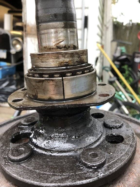

I adjusted the bearings and it seemed to take up a lot of play in the bearings. I took out the right side first and the left side. I cleaned them and looked at them and they seem to look ok but I did see a cut in the bearing race on the left side.

Wow! Never saw that happen!
The bearing races are hardened and that's a crack. No going back for that one... It needs to be replaced.

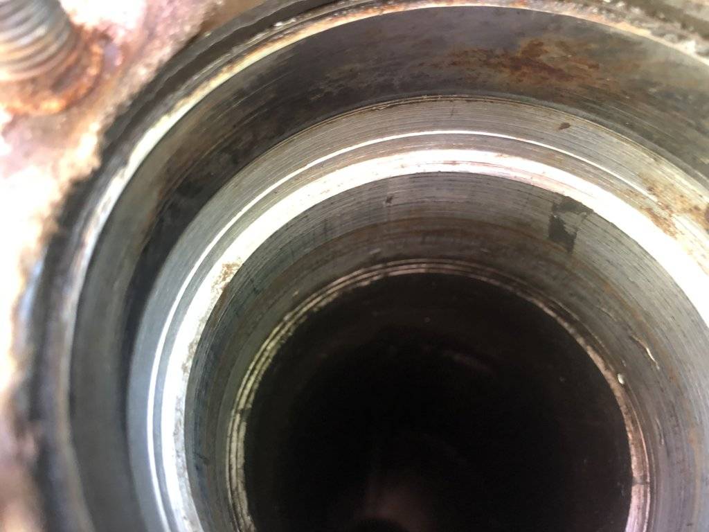

Check the bearing seat in the housing for gouges. It is all but impossible for the outer race to break unless there is something bad wrong with its seat.
Dave
Those look like machining marks as opposed to scoring, so it probably is ok. In a perfect world, you could mic the seat to see if it is the same as the other side, but it does not look scored to me.
