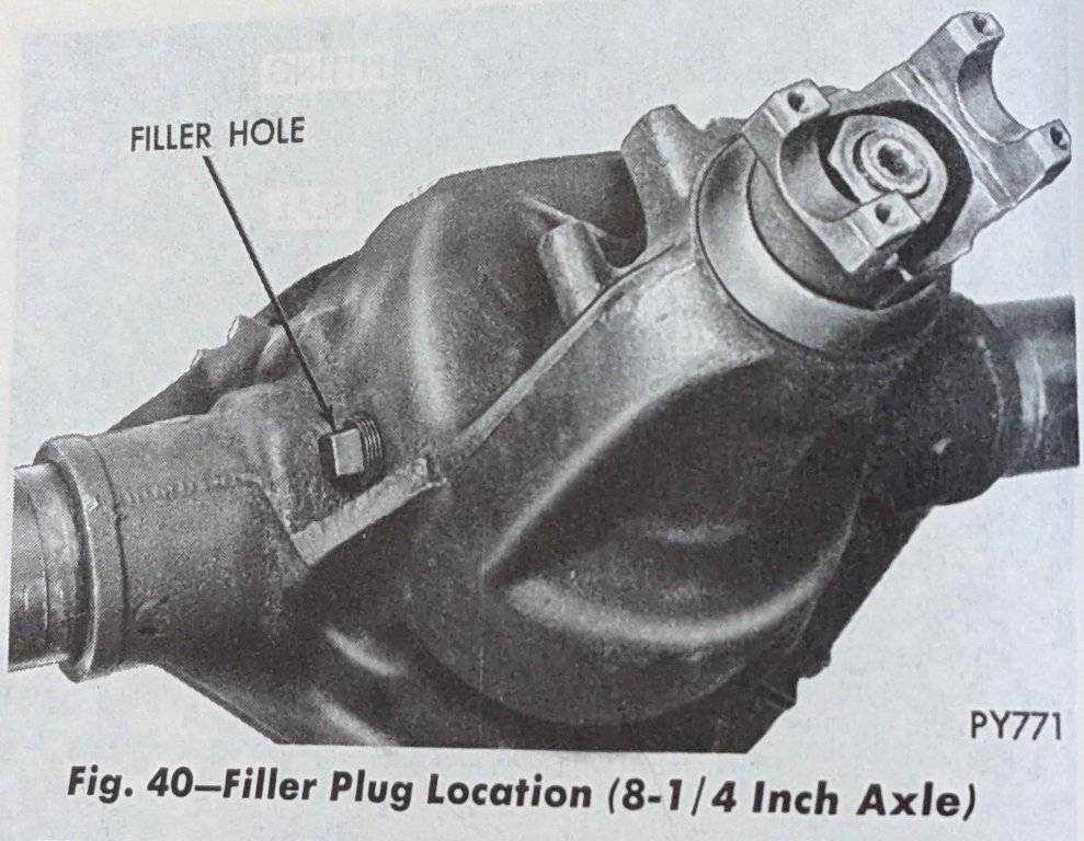

Hello i was wondering what rear end i have factory 318 car trying to find bolt to put oil in rear end View attachment 731329

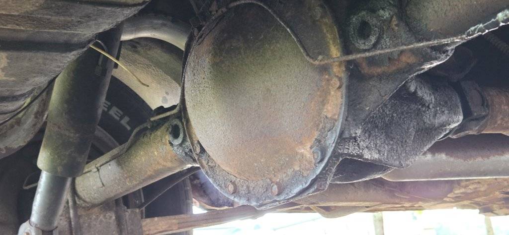

Thank you I found the plug what should I use to get it loose im trying a adjustable and can't break it looseThe rear axle pictured is an 8-1/4".
The early 8-1/4" axle had a threaded filler plug on the upper right of the differential casting.
This plug location was used from the initial 1969 8-1/4" axle until the late 1976 8-1/4" axles. In late 1976, the threaded filler plug for the 8-1/4" axle was relocated to a new cover using a rubber filler plug.

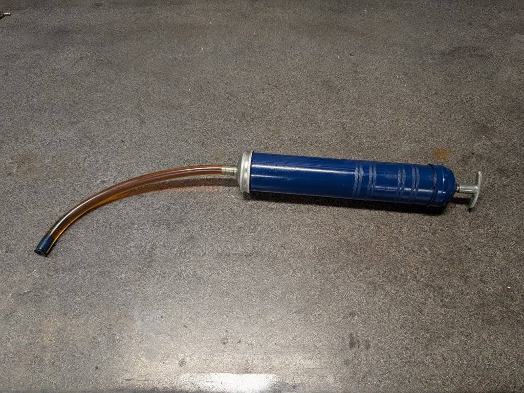

There is a manual suction device to remove the existing rear axle lube. Hand-held and operated. Every service station had one, back then. That way, no need to remove the rear cover, unless you want to.
