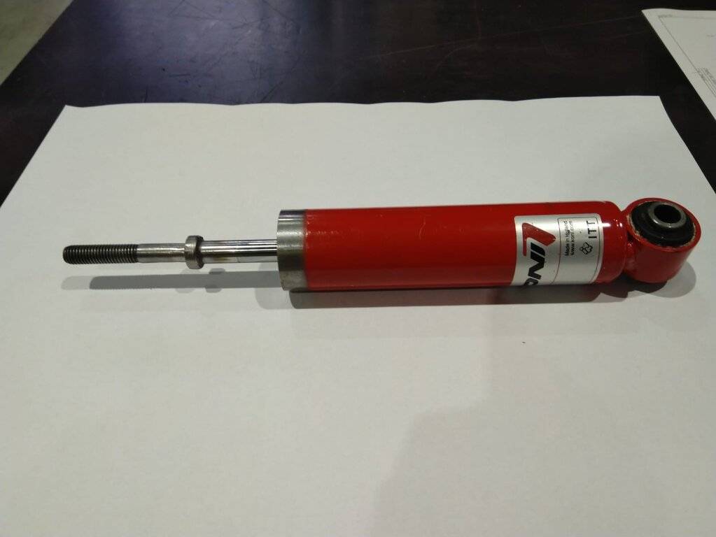

You didn’t state the price range you were looking into. My choice is not cheap, but it is among the best. A genuine Chrysler ride, soft, supple, but lasts for-ever, unlike the OEM Oriflows.
A modified pair of Konis. Just a sample:
Koni part #80-1011.
