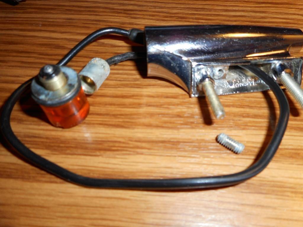

Here is a pic of the lens after you remove the set screw. Sometimes they get so corroded you crack the lens when the set screw is tightened. Pulling it out of the housing you can work it loose. It may have an oring on it so you will have to push it from the wire lead side.
