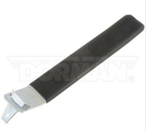

This is the tool you want to use. it's in stock at Rock Auto for 4 bucks.
DORMAN 49023 Wiper Arm Tool | RockAuto
