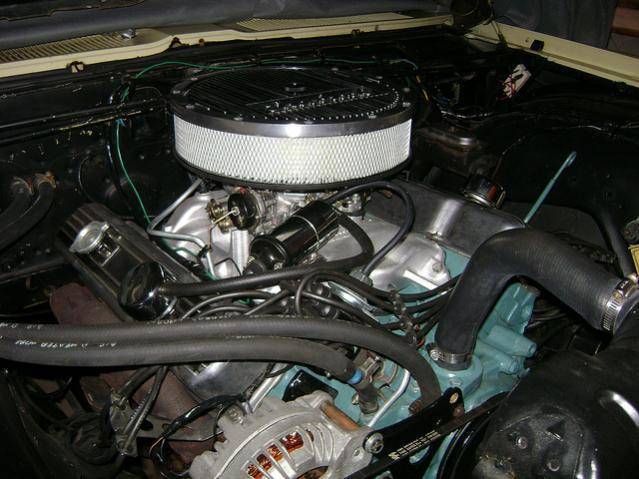

Direct bolt on since it sits on a Eddy Performer intake. Mechanic installed the carb after 440 rebuilt so I'm unsure what was done.
