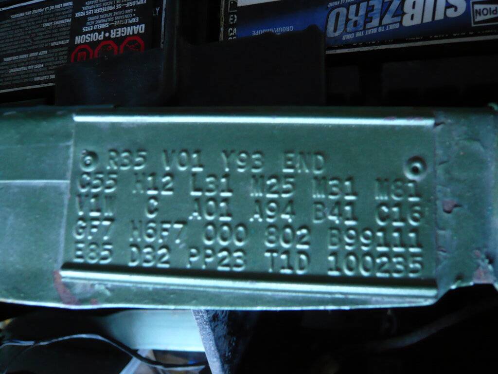

Granted the car looked good from 10 feet away but with this car possibly being the first 1971 produced, the fact that it has an August 2nd scheduled build date, has the lower sequence number of the 2 promotional 1971 GT's produced and the fender tag has the correct coding for a promotional car I felt that this GT deserved a correct restoration, however this will not be a trailer queen. I plan on driving this car.

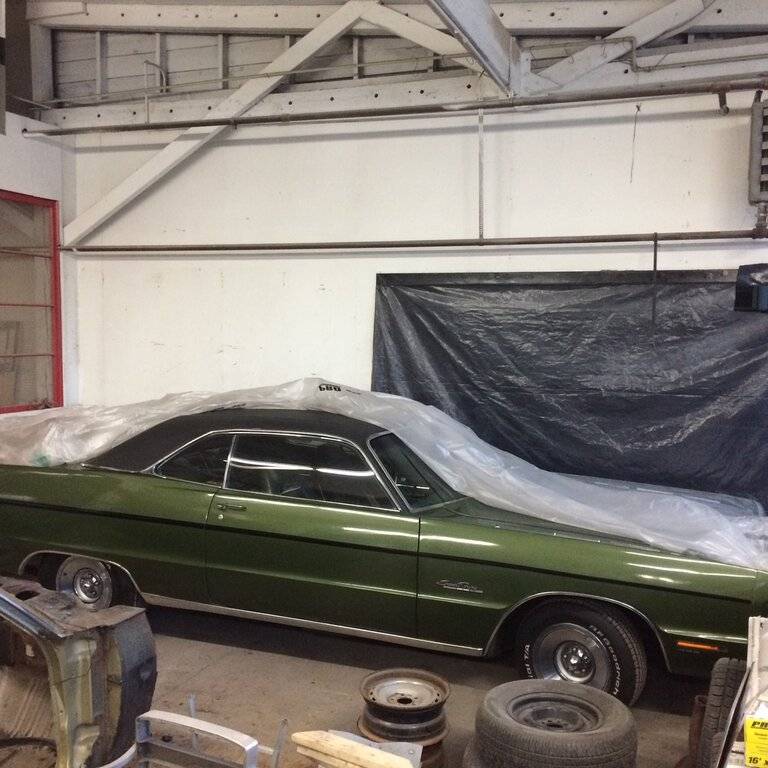

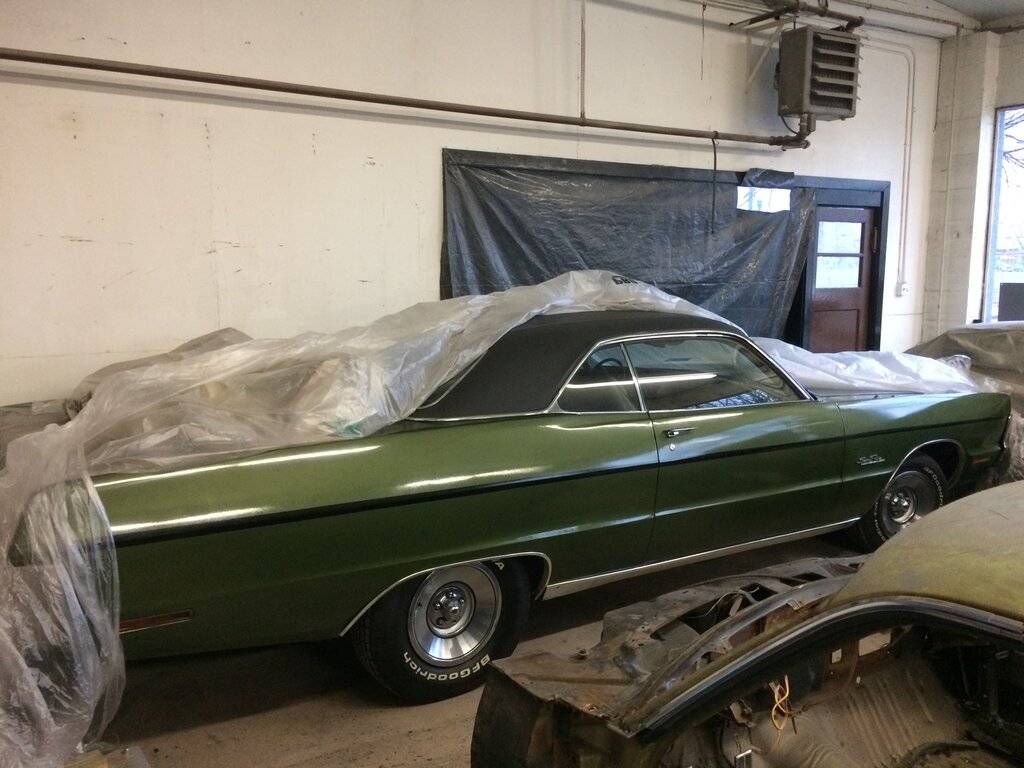

Photos of the GT when I purchased it:

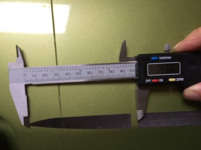

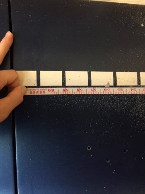

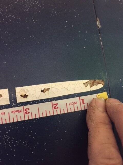

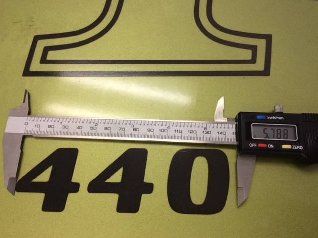

Photos of measurements from original stripes and of an older correct stripe kit on a GT. The center caps on this GT show NO evidence of ever having been painted. They look the photos of a similar prototype wheel that Chrysler made.

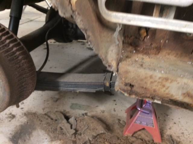

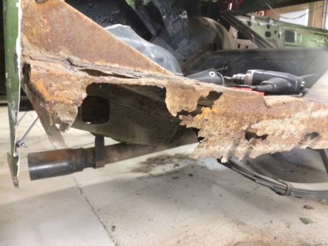

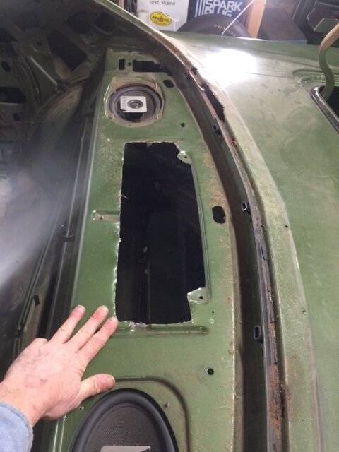

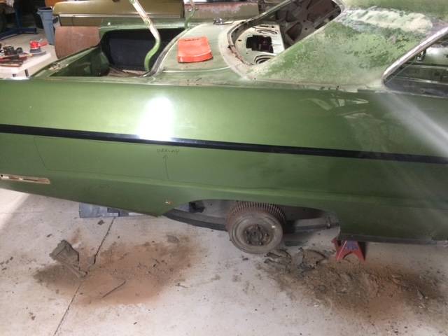

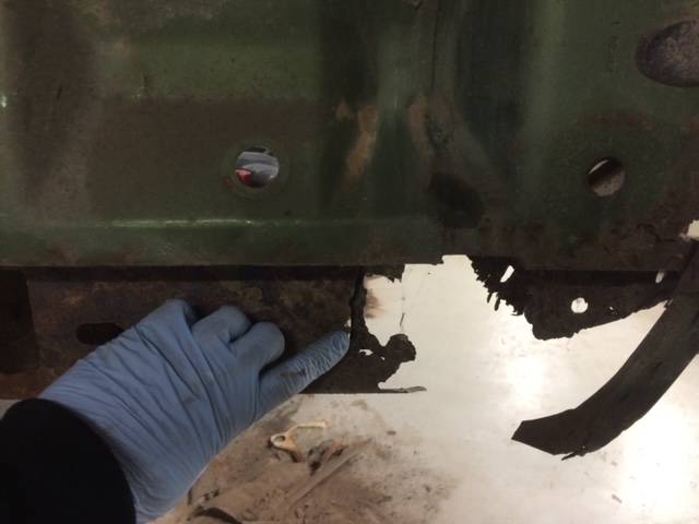

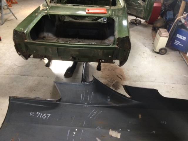

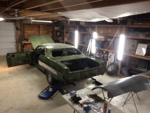

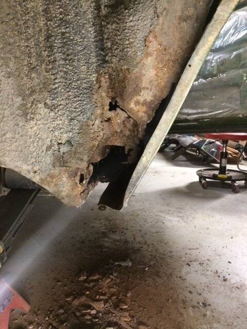

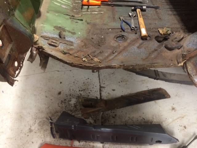

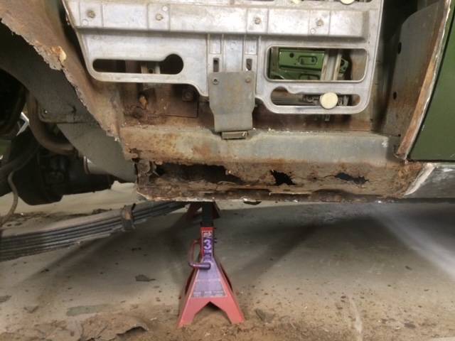

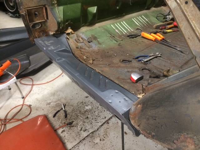

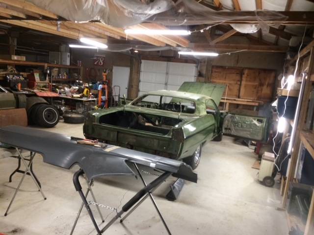

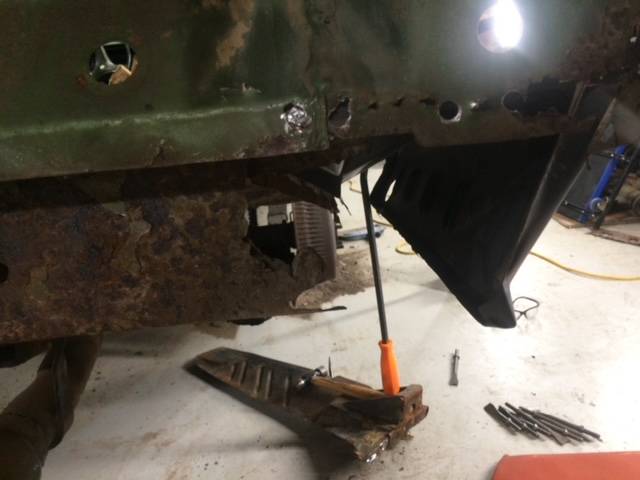

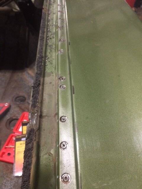

More photos randomly uploaded. The GT is in the process of receiving NOS quarter panels, trunk floor extensions, outer wheelhouses and a section of an NOS left rocker panel.

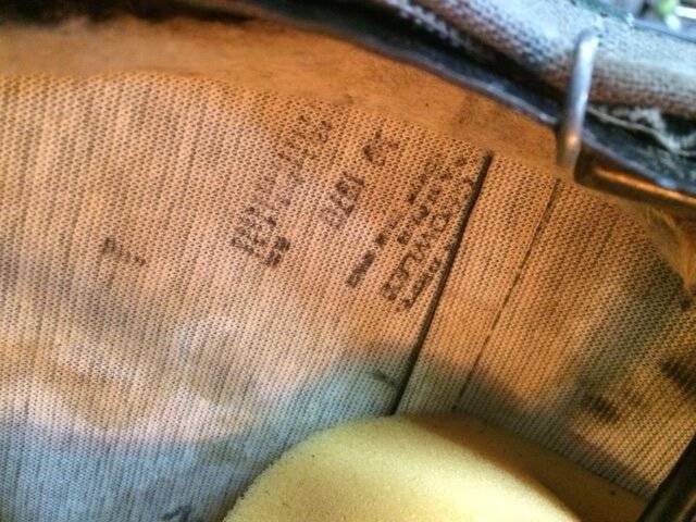

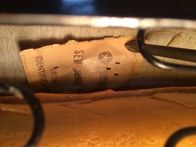

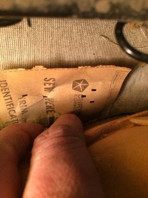

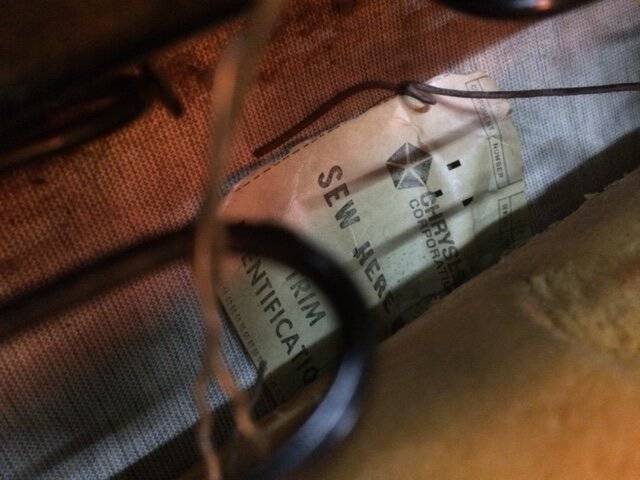

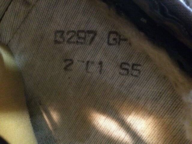

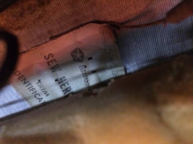

Here are some interesting photos. When Trev removed the original seat covers he found several IBM cards sewn into the back side of the seat covers with "SEW HERE" typed on them. I suspect these were hand made. Anyone else ever see these tags?
Why yes indeed -- I posted similar photos when I had the seats of Buttercup, my 1972 NYB, in September. @71Polara383 had the presence of mind to ask the upholsterer to save all of them, and he gave me photos. Comments/comparisons welcome!
PS: thank you for posting the article, always great to read about PP23T1D100235
Thanks for sharing the link to your IBM cards. They look very similar.
I just got my MCG yesterday and was surprised to see your car in there...it is also rustier than what was mentioned in the for sale ads for the car but it sure looks like you are doing the car the right way.
Good luck with the 1971 Sport Fury GT.
Dave
Here are some interesting photos. When Trev removed the original seat covers he found several IBM cards sewn into the back side of the seat covers with "SEW HERE" typed on them. I suspect these were hand made. Anyone else ever see these tags?View attachment 494480
View attachment 494475 View attachment 494476 View attachment 494477 View attachment 494478 View attachment 494479
I will be posting more photos when I have time.
Those are the factory tags on the seat upholstery. Not uncommon to find on original seat covers. I’ve observed many on all mopar body styles.
Chrysler made all of the interior seat covers in house.
A good friends mother worked in the upholstery shop at Dodge main for 40+ years. I had the opportunity to get some info from her on the process.
Basically, the seat patterns were laid out and cut from the vinyl including the corresponding backing material. All the individual pieces were then sewn by the seamstresses into the sections that make up each seatcover.
These panels were sorted by model and had a part number stamped on the backside and also on the paper tag (check the tags you have - there’s probably one printed on the tag). When a car was being built the seamstresses would get all the individual components and sew them into the “finished” seat cover.
The “sew here” tags were guides to ensure the seamstresses assembled each piece correctly and efficiently. Remember this was a production line !
